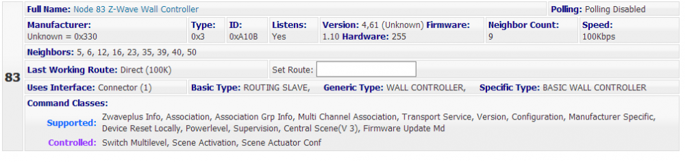

  3. Inkluderte nå node 82 non - secure Vil ikke si det hjalp så mye. Når det gjelder avstand så er det vel 3m fra der jeg sitter å legger inn bryteren til selve z-wave uzb dongelen (PC'n) Logg og bilder: Add Node started... Activate the 'Add to Network' function on the device... A new node is being added... Adding a new SLAVE NODE... DONE - Add Node Operation is Complete. Done. Node 83 Added. Reloading (importing) node information... Synchronizing node information with HomeSeer and creating new device(s) as necessary... Synchronize nodes finished. Number of device nodes to be created/added = 1 Z-Wave manufacturer information for node 83, ID: 816=330H (UNKNOWN), Type: 3=3H, ID: 41227=A10BH Node: 83 Supports Class(es): ZWAVEPLUS_INFO, ASSOCIATION_V2, ASSOCIATION_GRP_INFO_V2, MULTI_CHANNEL_ASSOCIATION_V3, TRANSPORT_SERVICE, VERSION_V2, CONFIGURATION_V4, MANUFACTURER_SPECIFIC_V2, DEVICE_RESET_LOCALLY, POWERLEVEL, SUPERVISION, CENTRAL_SCENE_V2, FIRMWARE_UPDATE_MD_V2 Node: 83 Controls Class(es): SWITCH_MULTILEVEL_V3, SCENE_ACTIVATION, SCENE_ACTUATOR_CONF Node 83 is Z-Wave version: Lib: 4,61 App: 1.10 Node 83 is a Z-Wave Plus node. Retrieving ZWPlus Info... All associations for node 83 have been retrieved successfully, it supports associations on these groups: 2, 3, 4. Finished. Saving network information to file: ZNet_MyNetwork_C2218D31_2018-05-10_16.35.58.ZWave. Please wait... Done!

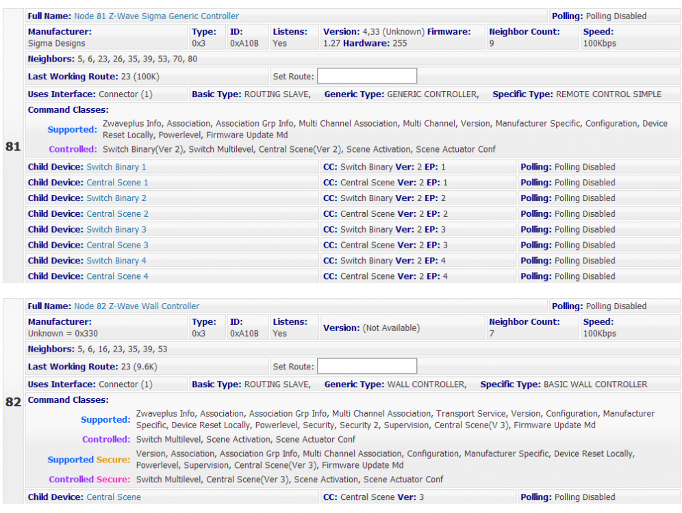

  5. Begge bryterene er kjøpt på intin, men med litt forskjell. Får Node 81 til å funke slik delvis men får ikke dimmingen til å funke. Derfor kjøpte jeg en til slik at jeg kunne sammenligne dem for å se om det var noe feil med den første hehe Z-Wave versjon:
  6. Dette er 2 like brytere, lagt inn secured. Men de gir meg litt forskjellige valg. Nedenfor er loggen til Node 82 Add Node started... Activate the 'Add to Network' function on the device... Activate the 'Add to Network' function on the device... A new node is being added... Adding a new SLAVE NODE... DONE - Add Node Operation is Complete. Done. Node 82 Added. Reloading (importing) node information... Synchronizing node information with HomeSeer and creating new device(s) as necessary... Synchronize nodes finished. Number of device nodes to be created/added = 1 Adding using S0 Security, Negotiating or Verifying SECURITY SCHEME for node 82 Z-Wave Security Scheme and Key Exchange was successful for node 82, now waiting for the device to finish storing information before proceeding... Getting SECURITY class information for node 82 Z-Wave manufacturer information for node 82, ID: 816=330H (UNKNOWN), Type: 3=3H, ID: 41227=A10BH Node: 82 Supports Class(es): ZWAVEPLUS_INFO, ASSOCIATION_V2, ASSOCIATION_GRP_INFO_V2, MULTI_CHANNEL_ASSOCIATION_V3, TRANSPORT_SERVICE, VERSION_V2, CONFIGURATION_V4, MANUFACTURER_SPECIFIC_V2, DEVICE_RESET_LOCALLY, POWERLEVEL, SECURITY, SECURITY_2, SUPERVISION, CENTRAL_SCENE_V2, FIRMWARE_UPDATE_MD_V2 Node: 82 Supports Secure Class(es): VERSION_V2, ASSOCIATION_V2, ASSOCIATION_GRP_INFO_V2, MULTI_CHANNEL_ASSOCIATION_V3, CONFIGURATION_V4, MANUFACTURER_SPECIFIC_V2, DEVICE_RESET_LOCALLY, POWERLEVEL, SUPERVISION, CENTRAL_SCENE_V2, FIRMWARE_UPDATE_MD_V2 Node: 82 Controls Class(es): SWITCH_MULTILEVEL_V3, SCENE_ACTIVATION, SCENE_ACTUATOR_CONF Node: 82 Controls Secure Class(es): SWITCH_MULTILEVEL_V3, CENTRAL_SCENE_V2, SCENE_ACTIVATION, SCENE_ACTUATOR_CONF Node 82 is a Z-Wave Plus node. Retrieving ZWPlus Info... All associations for node 82 have been retrieved successfully, it supports associations on these groups: 1, 2, 3, 4, 5. Root Node Device Node 82 Z-Wave Wall Controller was created for node 82 on network C2218D31 Connector: Adding association for Z-Wave device Node 82 Z-Wave Wall Controller (Node 82, Group 1) to HomeSeer 1 out of 1 Child devices of node 82 were created successfully. Finished. Saving network information to file: ZNet_MyNetwork_C2218D31_2018-05-09_16.23.05.ZWave. Please wait... Done!

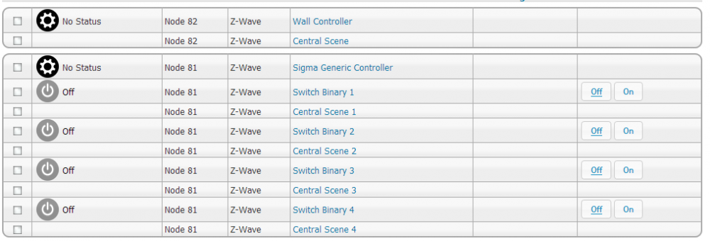

  7. Vel, jeg har nå 2 slike dimmere. Fjernet den jeg hadde og la den inn på ny og den kommer kun inn med 1 enhet, før hadde den 4 bryter enheter og 4 scenarioer + kontrolleren. Sent fra min BLA-L29 via Tapatalk

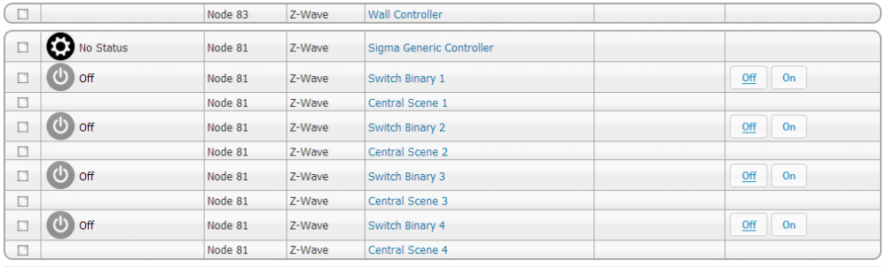

  8. Fikk en ny Sunricher glass dimmer i dag, da jeg mistenkte noe var feil med den gamle jeg har. La den til secure, deretter non secure men det kommer bare opp som en modul "Sigma generic controller", får ikke knappe alternativene som jeg gjorde før. Kan det ha noe med den siste HS3 oppdateringen å gjøre? Noen forslag ?? Link til aktuelle bryter: https://www.intin.no/produkt/sunricher-4-kanal-glass-dimmer/
  9. Men slik ser jo RGB bryteren ut... Den har litt ekstra parametere. Slik som Custom Color, skal det ikke være noe slik for dimmeren også, antar at det er dimme hjulet som er custom color...

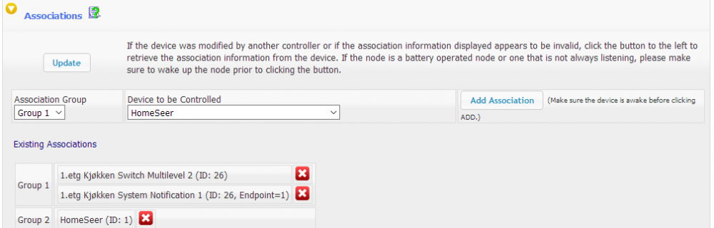

  12. Er det noen som har et bilde av en sunricher 4 kanal dimmer. Har en liten misstanke om at min mangler noe. Har slettet den og tatt "factory reset" et par ganger i dag og den legger seg til på samme måte hver gang. Slik ser da min ut. Når jeg trykker på S1,S2, S3 og S4 så er det Central Scene X som blir oppdatert. Får ikke direkte assosiering til å virke, heller ikke dimmingen til å gi noen verdi. Har på følelsen av dimmingen mangler en komponent i bildet over, siden jeg kom over denne tråden: Der man ser at hjulet på denne RGB enheten har en egen "Device" Slik ser min assosiering ut. Med denne assosieringen kommuniserer jeg kun med homeseer. Har forsøkt å bytte ut HomeSeer med selve komponenten men uten at det har gitt noe effekt enda. Så noe jeg gjør feil her.
  13. Da har jeg testet en go del i dag. Lært litt om hvordan man "aktiverer" brytren slik at den mottar komandoer osv Testet litt avstand (rekkevidde) Får bryteren til å virke mot homeseer, men ikke direkte mot komponenten (dimmer modulen via assosiering) Via homeseer så er bryteren kun on/off og jeg får ikke dimmet. Mulig det går å lage en event på dette. Men hadde vært gøy å fått til assosiering snart også, har fortsatt ikke fått dette til på noen av mine 3 trådløse brytere.

  19. Jeg sliter litt med å få " Association " til å virke Når jeg setter opp Association så virker det veldig vilkårlig hva slags element den setter inn, her er en Mertel (Schnider) bryter jeg prøver å få til å virke. Der skal vistnok gruppe 1 være dimmeren og gruppe 2 være homeseer, har når jeg klikker på device så får jeg opp enheten jeg vil styre, men kun 1 valg. har lagt den til 2 ganger for å se hva som skjer og den legger til et nytt element hver gang, hvordan kan jeg kontrollere dette? er vel Switch Mulitlevel 1 jeg er ute etter å kontrollere.
