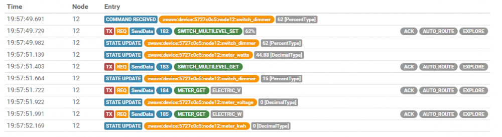

  1. Ble mye logging såklart 2020-11-23 19:57:38.974 [DEBUG] [nal.protocol.ZWaveTransactionManager] - Transaction SendNextMessage 0 out at start. Holdoff false. 2020-11-23 19:57:49.691 [DEBUG] [ding.zwave.handler.ZWaveThingHandler] - NODE 12: Command received zwave:device:5727c0c5:node12:switch_dimmer --> 62 [PercentType] 2020-11-23 19:57:49.696 [DEBUG] [ss.ZWaveMultiLevelSwitchCommandClass] - NODE 12: Creating new message for command SWITCH_MULTILEVEL_SET 2020-11-23 19:57:49.700 [DEBUG] [ng.zwave.internal.protocol.ZWaveNode] - NODE 12: SECURITY NOT required on COMMAND_CLASS_SWITCH_MULTILEVEL 2020-11-23 19:57:49.704 [DEBUG] [ng.zwave.internal.protocol.ZWaveNode] - NODE 12: Command Class COMMAND_CLASS_SWITCH_MULTILEVEL is NOT required to be secured 2020-11-23 19:57:49.709 [DEBUG] [nal.protocol.ZWaveTransactionManager] - NODE 12: Adding to device queue 2020-11-23 19:57:49.713 [DEBUG] [nal.protocol.ZWaveTransactionManager] - NODE 12: Added 835 to queue - size 3 2020-11-23 19:57:49.718 [DEBUG] [nal.protocol.ZWaveTransactionManager] - Transaction SendNextMessage 0 out at start. Holdoff false. 2020-11-23 19:57:49.724 [DEBUG] [wave.internal.protocol.SerialMessage] - Assembled message buffer = 01 0A 00 13 0C 03 26 01 3E 25 B6 63 2020-11-23 19:57:49.729 [DEBUG] [ing.zwave.handler.ZWaveSerialHandler] - NODE 12: Sending REQUEST Message = 01 0A 00 13 0C 03 26 01 3E 25 B6 63 2020-11-23 19:57:49.736 [DEBUG] [WaveSerialHandler$ZWaveReceiveThread] - Receive Message = 06 2020-11-23 19:57:49.734 [DEBUG] [ing.zwave.handler.ZWaveSerialHandler] - Message SENT 2020-11-23 19:57:49.743 [DEBUG] [nal.protocol.ZWaveTransactionManager] - processReceiveMessage input 0<>128 : Message: class=null[0], type=ACK[2], dest=255, callback=0, payload= 2020-11-23 19:57:49.747 [DEBUG] [nal.protocol.ZWaveTransactionManager] - Received msg (0): Message: class=null[0], type=ACK[2], dest=255, callback=0, payload= 2020-11-23 19:57:49.749 [DEBUG] [WaveSerialHandler$ZWaveReceiveThread] - Receive Message = 01 04 01 13 01 E8 2020-11-23 19:57:49.752 [DEBUG] [nal.protocol.ZWaveTransactionManager] - lastTransaction null 2020-11-23 19:57:49.751 [DEBUG] [nal.protocol.ZWaveTransactionManager] - Transaction SendNextMessage started: TID 835: [WAIT_RESPONSE] priority=Set, requiresResponse=true, callback: 182 2020-11-23 19:57:49.756 [DEBUG] [nal.protocol.ZWaveTransactionManager] - Received msg: ACK 2020-11-23 19:57:49.756 [DEBUG] [nal.protocol.ZWaveTransactionManager] - processReceiveMessage input 0<>128 : Message: class=SendData[19], type=Response[1], dest=255, callback=0, payload=01 2020-11-23 19:57:49.763 [DEBUG] [nal.protocol.ZWaveTransactionManager] - ZWaveReceiveThread queue empty 2020-11-23 19:57:49.767 [DEBUG] [WaveSerialHandler$ZWaveReceiveThread] - Receive Message = 01 07 00 13 B6 00 00 02 5F 2020-11-23 19:57:49.772 [DEBUG] [nal.protocol.ZWaveTransactionManager] - processReceiveMessage input 1<>127 : Message: class=SendData[19], type=Request[0], dest=0, callback=182, payload=B6 00 00 02 2020-11-23 19:57:49.775 [DEBUG] [nal.protocol.ZWaveTransactionManager] - Transaction SendNextMessage 1 out at start. Holdoff false. 2020-11-23 19:57:49.784 [DEBUG] [ding.zwave.handler.ZWaveThingHandler] - NODE 12: Polling initialised at 86400 seconds - start in 1500 milliseconds. 2020-11-23 19:57:49.788 [DEBUG] [nal.protocol.ZWaveTransactionManager] - Received msg (1): Message: class=SendData[19], type=Response[1], dest=255, callback=0, payload=01 2020-11-23 19:57:49.796 [DEBUG] [WaveSerialHandler$ZWaveReceiveThread] - Receive Message = 01 0A 00 04 00 0C 04 26 01 3E FF 1F 2020-11-23 19:57:49.798 [DEBUG] [nal.protocol.ZWaveTransactionManager] - lastTransaction TID 835: [WAIT_RESPONSE] priority=Set, requiresResponse=true, callback: 182 2020-11-23 19:57:49.813 [DEBUG] [nal.protocol.ZWaveTransactionManager] - Checking outstanding transactions: 1 2020-11-23 19:57:49.815 [DEBUG] [nal.protocol.ZWaveTransactionManager] - processReceiveMessage input 1<>127 : Message: class=ApplicationCommandHandler[4], type=Request[0], dest=12, callback=0, payload=00 0C 04 26 01 3E FF 2020-11-23 19:57:49.817 [DEBUG] [nal.protocol.ZWaveTransactionManager] - Last transaction: TID 835: [WAIT_RESPONSE] priority=Set, requiresResponse=true, callback: 182 2020-11-23 19:57:49.829 [DEBUG] [ve.internal.protocol.ZWaveController] - Incoming Message: Message: class=SendData[19], type=Response[1], dest=255, callback=0, payload=01 2020-11-23 19:57:49.838 [DEBUG] [l.serialmessage.SendDataMessageClass] - NODE 12: sentData successfully placed on stack. 2020-11-23 19:57:49.843 [DEBUG] [nal.protocol.ZWaveTransactionManager] - TID 835: Advanced to WAIT_REQUEST 2020-11-23 19:57:49.849 [DEBUG] [nal.protocol.ZWaveTransactionManager] - NODE 12: TID 835: Transaction not completed 2020-11-23 19:57:49.855 [DEBUG] [nal.protocol.ZWaveTransactionManager] - Received msg (1): Message: class=SendData[19], type=Request[0], dest=0, callback=182, payload=B6 00 00 02 2020-11-23 19:57:49.861 [DEBUG] [nal.protocol.ZWaveTransactionManager] - lastTransaction TID 835: [WAIT_REQUEST] priority=Set, requiresResponse=true, callback: 182 2020-11-23 19:57:49.868 [DEBUG] [nal.protocol.ZWaveTransactionManager] - Checking outstanding transactions: 1 2020-11-23 19:57:49.872 [DEBUG] [nal.protocol.ZWaveTransactionManager] - Last transaction: TID 835: [WAIT_REQUEST] priority=Set, requiresResponse=true, callback: 182 2020-11-23 19:57:49.876 [DEBUG] [nal.protocol.ZWaveTransactionManager] - Checking TID 835: (Callback 182) 2020-11-23 19:57:49.885 [DEBUG] [.serialmessage.ZWaveCommandProcessor] - Callback match! 2020-11-23 19:57:49.890 [DEBUG] [nal.protocol.ZWaveTransactionManager] - Correlated to TID 835: callback 182 2020-11-23 19:57:49.897 [DEBUG] [ve.internal.protocol.ZWaveController] - Incoming Message: Message: class=SendData[19], type=Request[0], dest=0, callback=182, payload=B6 00 00 02 2020-11-23 19:57:49.901 [DEBUG] [l.serialmessage.SendDataMessageClass] - NODE 12: SendData Request. CallBack ID = 182, Status = Transmission complete and ACK received(0) 2020-11-23 19:57:49.906 [DEBUG] [ng.zwave.internal.protocol.ZWaveNode] - NODE 12: resetResendCount initComplete=true isDead=false 2020-11-23 19:57:49.911 [DEBUG] [e.internal.protocol.ZWaveTransaction] - TID 835: Transaction COMPLETED 2020-11-23 19:57:49.915 [DEBUG] [nal.protocol.ZWaveTransactionManager] - NODE 12: Response processed after 164ms 2020-11-23 19:57:49.919 [DEBUG] [nal.protocol.ZWaveTransactionManager] - NODE 12: TID 835: Transaction completed 2020-11-23 19:57:49.923 [DEBUG] [nal.protocol.ZWaveTransactionManager] - NODE 12: notifyTransactionResponse TID:835 DONE 2020-11-23 19:57:49.930 [DEBUG] [ding.zwave.handler.ZWaveThingHandler] - NODE 12: Got an event from Z-Wave network: ZWaveTransactionCompletedEvent 2020-11-23 19:57:49.938 [DEBUG] [nal.protocol.ZWaveTransactionManager] - Received msg (0): Message: class=ApplicationCommandHandler[4], type=Request[0], dest=12, callback=0, payload=00 0C 04 26 01 3E FF 2020-11-23 19:57:49.942 [DEBUG] [nal.protocol.ZWaveTransactionManager] - lastTransaction null 2020-11-23 19:57:49.946 [DEBUG] [nal.protocol.ZWaveTransactionManager] - NODE 12: Application Command Request (ALIVE:DONE) 2020-11-23 19:57:49.953 [DEBUG] [ng.zwave.internal.protocol.ZWaveNode] - NODE 12: resetResendCount initComplete=true isDead=false 2020-11-23 19:57:49.957 [DEBUG] [ng.zwave.internal.protocol.ZWaveNode] - NODE 12: Incoming command class COMMAND_CLASS_SWITCH_MULTILEVEL, endpoint 0 2020-11-23 19:57:49.962 [DEBUG] [ng.zwave.internal.protocol.ZWaveNode] - NODE 12: SECURITY NOT required on COMMAND_CLASS_SWITCH_MULTILEVEL 2020-11-23 19:57:49.966 [DEBUG] [tocol.commandclass.ZWaveCommandClass] - NODE 12: Received COMMAND_CLASS_SWITCH_MULTILEVEL V2 SWITCH_MULTILEVEL_SET 2020-11-23 19:57:49.970 [DEBUG] [ss.ZWaveMultiLevelSwitchCommandClass] - NODE 12: Switch Multi Level set, value = 62 2020-11-23 19:57:49.974 [DEBUG] [ding.zwave.handler.ZWaveThingHandler] - NODE 12: Got an event from Z-Wave network: ZWaveCommandClassValueEvent 2020-11-23 19:57:49.978 [DEBUG] [ding.zwave.handler.ZWaveThingHandler] - NODE 12: Got a value event from Z-Wave network, endpoint=0, command class=COMMAND_CLASS_SWITCH_MULTILEVEL, value=62 2020-11-23 19:57:49.982 [DEBUG] [ding.zwave.handler.ZWaveThingHandler] - NODE 12: Updating channel state zwave:device:5727c0c5:node12:switch_dimmer to 62 [PercentType] 2020-11-23 19:57:49.986 [DEBUG] [nal.protocol.ZWaveTransactionManager] - NODE 12: Commands processed 1. 2020-11-23 19:57:49.991 [DEBUG] [nal.protocol.ZWaveTransactionManager] - NODE 12: Checking command org.openhab.binding.zwave.internal.protocol.ZWaveCommandClassPayload@1d8291. 2020-11-23 19:57:49.995 [DEBUG] [nal.protocol.ZWaveTransactionManager] - Transaction completed - outstandingTransactions 0 2020-11-23 19:57:49.998 [DEBUG] [nal.protocol.ZWaveTransactionManager] - Transaction completed - outstandingTransactions 0 2020-11-23 19:57:50.002 [DEBUG] [nal.protocol.ZWaveTransactionManager] - ZWaveReceiveThread queue empty 2020-11-23 19:57:50.005 [DEBUG] [nal.protocol.ZWaveTransactionManager] - Transaction SendNextMessage 0 out at start. Holdoff false. ==> /var/log/openhab2/events.log <== 2020-11-23 19:57:49.650 [ome.event.ItemCommandEvent] - Item 'masterbedroom_dimmer' received command 62 2020-11-23 19:57:49.671 [nt.ItemStatePredictedEvent] - masterbedroom_dimmer predicted to become 62 2020-11-23 19:57:49.691 [vent.ItemStateChangedEvent] - masterbedroom_dimmer changed from 15 to 62 ==> /var/log/openhab2/openhab.log <== 2020-11-23 19:57:51.067 [DEBUG] [WaveSerialHandler$ZWaveReceiveThread] - Receive Message = 01 10 00 04 00 0C 0A 32 02 21 54 00 00 11 88 00 00 31 2020-11-23 19:57:51.074 [DEBUG] [nal.protocol.ZWaveTransactionManager] - processReceiveMessage input 0<>128 : Message: class=ApplicationCommandHandler[4], type=Request[0], dest=12, callback=0, payload=00 0C 0A 32 02 21 54 00 00 11 88 00 00 2020-11-23 19:57:51.080 [DEBUG] [nal.protocol.ZWaveTransactionManager] - Received msg (0): Message: class=ApplicationCommandHandler[4], type=Request[0], dest=12, callback=0, payload=00 0C 0A 32 02 21 54 00 00 11 88 00 00 2020-11-23 19:57:51.088 [DEBUG] [nal.protocol.ZWaveTransactionManager] - lastTransaction null 2020-11-23 19:57:51.093 [DEBUG] [nal.protocol.ZWaveTransactionManager] - NODE 12: Application Command Request (ALIVE:DONE) 2020-11-23 19:57:51.097 [DEBUG] [ng.zwave.internal.protocol.ZWaveNode] - NODE 12: resetResendCount initComplete=true isDead=false 2020-11-23 19:57:51.106 [DEBUG] [ng.zwave.internal.protocol.ZWaveNode] - NODE 12: Incoming command class COMMAND_CLASS_METER, endpoint 0 2020-11-23 19:57:51.112 [DEBUG] [ng.zwave.internal.protocol.ZWaveNode] - NODE 12: SECURITY NOT required on COMMAND_CLASS_METER 2020-11-23 19:57:51.117 [DEBUG] [tocol.commandclass.ZWaveCommandClass] - NODE 12: Received COMMAND_CLASS_METER V3 METER_REPORT 2020-11-23 19:57:51.124 [DEBUG] [.commandclass.ZWaveMeterCommandClass] - NODE 12: Meter: Type=Electric(1), Scale=W(2), Value=44.88 2020-11-23 19:57:51.130 [DEBUG] [ding.zwave.handler.ZWaveThingHandler] - NODE 12: Got an event from Z-Wave network: ZWaveMeterValueEvent 2020-11-23 19:57:51.135 [DEBUG] [ding.zwave.handler.ZWaveThingHandler] - NODE 12: Got a value event from Z-Wave network, endpoint=0, command class=COMMAND_CLASS_METER, value=44.88 2020-11-23 19:57:51.139 [DEBUG] [ding.zwave.handler.ZWaveThingHandler] - NODE 12: Updating channel state zwave:device:5727c0c5:node12:meter_watts to 44.88 [DecimalType] 2020-11-23 19:57:51.145 [DEBUG] [nal.protocol.ZWaveTransactionManager] - NODE 12: Commands processed 1. 2020-11-23 19:57:51.149 [DEBUG] [nal.protocol.ZWaveTransactionManager] - NODE 12: Checking command org.openhab.binding.zwave.internal.protocol.ZWaveCommandClassPayload@1972f2b. 2020-11-23 19:57:51.159 [DEBUG] [nal.protocol.ZWaveTransactionManager] - Transaction completed - outstandingTransactions 0 2020-11-23 19:57:51.171 [DEBUG] [nal.protocol.ZWaveTransactionManager] - Transaction completed - outstandingTransactions 0 2020-11-23 19:57:51.177 [DEBUG] [nal.protocol.ZWaveTransactionManager] - ZWaveReceiveThread queue empty 2020-11-23 19:57:51.183 [DEBUG] [nal.protocol.ZWaveTransactionManager] - Transaction SendNextMessage 0 out at start. Holdoff false. 2020-11-23 19:57:51.261 [DEBUG] [ding.zwave.handler.ZWaveThingHandler] - NODE 12: Polling... 2020-11-23 19:57:51.267 [DEBUG] [ding.zwave.handler.ZWaveThingHandler] - NODE 12: Polling zwave:device:5727c0c5:node12:switch_dimmer 2020-11-23 19:57:51.274 [DEBUG] [erter.ZWaveMultiLevelSwitchConverter] - NODE 12: Generating poll message for COMMAND_CLASS_SWITCH_MULTILEVEL, endpoint 0 2020-11-23 19:57:51.280 [DEBUG] [ss.ZWaveMultiLevelSwitchCommandClass] - NODE 12: Creating new message for command SWITCH_MULTILEVEL_GET 2020-11-23 19:57:51.286 [DEBUG] [ng.zwave.internal.protocol.ZWaveNode] - NODE 12: SECURITY NOT required on COMMAND_CLASS_SWITCH_MULTILEVEL 2020-11-23 19:57:51.292 [DEBUG] [ng.zwave.internal.protocol.ZWaveNode] - NODE 12: Command Class COMMAND_CLASS_SWITCH_MULTILEVEL is NOT required to be secured 2020-11-23 19:57:51.296 [DEBUG] [ding.zwave.handler.ZWaveThingHandler] - NODE 12: Polling skipped for zwave:device:5727c0c5:node12:switch_dimmer on COMMAND_CLASS_BASIC 2020-11-23 19:57:51.301 [DEBUG] [ding.zwave.handler.ZWaveThingHandler] - NODE 12: Polling zwave:device:5727c0c5:node12:meter_voltage 2020-11-23 19:57:51.305 [DEBUG] [ternal.converter.ZWaveMeterConverter] - NODE 12: Generating poll message for COMMAND_CLASS_METER, endpoint 0 2020-11-23 19:57:51.309 [DEBUG] [ternal.converter.ZWaveMeterConverter] - NODE 12: Generating poll message for COMMAND_CLASS_METER, endpoint 0 2020-11-23 19:57:51.313 [DEBUG] [.commandclass.ZWaveMeterCommandClass] - NODE 12: Creating new message for application command METER_GET 2020-11-23 19:57:51.322 [DEBUG] [ng.zwave.internal.protocol.ZWaveNode] - NODE 12: SECURITY NOT required on COMMAND_CLASS_METER 2020-11-23 19:57:51.325 [DEBUG] [ng.zwave.internal.protocol.ZWaveNode] - NODE 12: Command Class COMMAND_CLASS_METER is NOT required to be secured ==> /var/log/openhab2/events.log <== 2020-11-23 19:57:51.153 [vent.ItemStateChangedEvent] - MasterBedroom_dimmer_ElectricMeterWatts changed from 7.9 to 44.88 ==> /var/log/openhab2/openhab.log <== 2020-11-23 19:57:51.335 [DEBUG] [ding.zwave.handler.ZWaveThingHandler] - NODE 12: Polling zwave:device:5727c0c5:node12:meter_watts 2020-11-23 19:57:51.342 [DEBUG] [ternal.converter.ZWaveMeterConverter] - NODE 12: Generating poll message for COMMAND_CLASS_METER, endpoint 0 2020-11-23 19:57:51.346 [DEBUG] [ternal.converter.ZWaveMeterConverter] - NODE 12: Generating poll message for COMMAND_CLASS_METER, endpoint 0 2020-11-23 19:57:51.352 [DEBUG] [.commandclass.ZWaveMeterCommandClass] - NODE 12: Creating new message for application command METER_GET 2020-11-23 19:57:51.360 [DEBUG] [ng.zwave.internal.protocol.ZWaveNode] - NODE 12: SECURITY NOT required on COMMAND_CLASS_METER 2020-11-23 19:57:51.368 [DEBUG] [ng.zwave.internal.protocol.ZWaveNode] - NODE 12: Command Class COMMAND_CLASS_METER is NOT required to be secured 2020-11-23 19:57:51.374 [DEBUG] [nal.protocol.ZWaveTransactionManager] - NODE 12: Adding to device queue 2020-11-23 19:57:51.380 [DEBUG] [nal.protocol.ZWaveTransactionManager] - NODE 12: Added 836 to queue - size 3 2020-11-23 19:57:51.387 [DEBUG] [nal.protocol.ZWaveTransactionManager] - Transaction SendNextMessage 0 out at start. Holdoff false. 2020-11-23 19:57:51.394 [DEBUG] [wave.internal.protocol.SerialMessage] - Assembled message buffer = 01 09 00 13 0C 02 26 02 25 B7 5D 2020-11-23 19:57:51.403 [DEBUG] [ing.zwave.handler.ZWaveSerialHandler] - NODE 12: Sending REQUEST Message = 01 09 00 13 0C 02 26 02 25 B7 5D 2020-11-23 19:57:51.409 [DEBUG] [ing.zwave.handler.ZWaveSerialHandler] - Message SENT 2020-11-23 19:57:51.411 [DEBUG] [WaveSerialHandler$ZWaveReceiveThread] - Receive Message = 06 2020-11-23 19:57:51.413 [DEBUG] [nal.protocol.ZWaveTransactionManager] - Transaction SendNextMessage started: TID 836: [WAIT_RESPONSE] priority=Get, requiresResponse=true, callback: 183 2020-11-23 19:57:51.420 [DEBUG] [nal.protocol.ZWaveTransactionManager] - NODE 12: Adding to device queue 2020-11-23 19:57:51.424 [DEBUG] [nal.protocol.ZWaveTransactionManager] - NODE 12: Added 837 to queue - size 3 2020-11-23 19:57:51.426 [DEBUG] [nal.protocol.ZWaveTransactionManager] - processReceiveMessage input 0<>128 : Message: class=null[0], type=ACK[2], dest=255, callback=0, payload= 2020-11-23 19:57:51.431 [DEBUG] [nal.protocol.ZWaveTransactionManager] - Received msg (0): Message: class=null[0], type=ACK[2], dest=255, callback=0, payload= 2020-11-23 19:57:51.428 [DEBUG] [nal.protocol.ZWaveTransactionManager] - Transaction SendNextMessage 1 out at start. Holdoff false. 2020-11-23 19:57:51.435 [DEBUG] [WaveSerialHandler$ZWaveReceiveThread] - Receive Message = 01 04 01 13 01 E8 2020-11-23 19:57:51.437 [DEBUG] [nal.protocol.ZWaveTransactionManager] - lastTransaction TID 836: [WAIT_RESPONSE] priority=Get, requiresResponse=true, callback: 183 2020-11-23 19:57:51.442 [DEBUG] [nal.protocol.ZWaveTransactionManager] - Received msg: ACK 2020-11-23 19:57:51.447 [DEBUG] [nal.protocol.ZWaveTransactionManager] - ZWaveReceiveThread queue empty 2020-11-23 19:57:51.445 [DEBUG] [nal.protocol.ZWaveTransactionManager] - NODE 12: Adding to device queue 2020-11-23 19:57:51.457 [DEBUG] [nal.protocol.ZWaveTransactionManager] - NODE 12: Added 838 to queue - size 4 2020-11-23 19:57:51.462 [DEBUG] [nal.protocol.ZWaveTransactionManager] - Transaction SendNextMessage 1 out at start. Holdoff false. 2020-11-23 19:57:51.443 [DEBUG] [nal.protocol.ZWaveTransactionManager] - processReceiveMessage input 0<>128 : Message: class=SendData[19], type=Response[1], dest=255, callback=0, payload=01 2020-11-23 19:57:51.472 [DEBUG] [WaveSerialHandler$ZWaveReceiveThread] - Receive Message = 01 07 00 13 B7 00 00 03 5F 2020-11-23 19:57:51.474 [DEBUG] [nal.protocol.ZWaveTransactionManager] - Transaction SendNextMessage 1 out at start. Holdoff false. 2020-11-23 19:57:51.492 [DEBUG] [nal.protocol.ZWaveTransactionManager] - Received msg (0): Message: class=SendData[19], type=Response[1], dest=255, callback=0, payload=01 2020-11-23 19:57:51.490 [DEBUG] [nal.protocol.ZWaveTransactionManager] - processReceiveMessage input 1<>127 : Message: class=SendData[19], type=Request[0], dest=0, callback=183, payload=B7 00 00 03 2020-11-23 19:57:51.500 [DEBUG] [nal.protocol.ZWaveTransactionManager] - lastTransaction TID 836: [WAIT_RESPONSE] priority=Get, requiresResponse=true, callback: 183 2020-11-23 19:57:51.506 [DEBUG] [nal.protocol.ZWaveTransactionManager] - Checking outstanding transactions: 1 2020-11-23 19:57:51.509 [DEBUG] [WaveSerialHandler$ZWaveReceiveThread] - Receive Message = 01 09 00 04 00 0C 03 26 03 0F D7 2020-11-23 19:57:51.513 [DEBUG] [nal.protocol.ZWaveTransactionManager] - Last transaction: TID 836: [WAIT_RESPONSE] priority=Get, requiresResponse=true, callback: 183 2020-11-23 19:57:51.516 [DEBUG] [nal.protocol.ZWaveTransactionManager] - processReceiveMessage input 1<>127 : Message: class=ApplicationCommandHandler[4], type=Request[0], dest=12, callback=0, payload=00 0C 03 26 03 0F 2020-11-23 19:57:51.519 [DEBUG] [ve.internal.protocol.ZWaveController] - Incoming Message: Message: class=SendData[19], type=Response[1], dest=255, callback=0, payload=01 2020-11-23 19:57:51.525 [DEBUG] [l.serialmessage.SendDataMessageClass] - NODE 12: sentData successfully placed on stack. 2020-11-23 19:57:51.530 [DEBUG] [nal.protocol.ZWaveTransactionManager] - TID 836: Advanced to WAIT_REQUEST 2020-11-23 19:57:51.534 [DEBUG] [nal.protocol.ZWaveTransactionManager] - NODE 12: TID 836: Transaction not completed 2020-11-23 19:57:51.539 [DEBUG] [nal.protocol.ZWaveTransactionManager] - Received msg (1): Message: class=SendData[19], type=Request[0], dest=0, callback=183, payload=B7 00 00 03 2020-11-23 19:57:51.544 [DEBUG] [nal.protocol.ZWaveTransactionManager] - lastTransaction TID 836: [WAIT_REQUEST] priority=Get, requiresResponse=true, callback: 183 2020-11-23 19:57:51.548 [DEBUG] [nal.protocol.ZWaveTransactionManager] - Checking outstanding transactions: 1 2020-11-23 19:57:51.553 [DEBUG] [nal.protocol.ZWaveTransactionManager] - Last transaction: TID 836: [WAIT_REQUEST] priority=Get, requiresResponse=true, callback: 183 2020-11-23 19:57:51.557 [DEBUG] [nal.protocol.ZWaveTransactionManager] - Checking TID 836: (Callback 183) 2020-11-23 19:57:51.561 [DEBUG] [.serialmessage.ZWaveCommandProcessor] - Callback match! 2020-11-23 19:57:51.565 [DEBUG] [nal.protocol.ZWaveTransactionManager] - Correlated to TID 836: callback 183 2020-11-23 19:57:51.570 [DEBUG] [ve.internal.protocol.ZWaveController] - Incoming Message: Message: class=SendData[19], type=Request[0], dest=0, callback=183, payload=B7 00 00 03 2020-11-23 19:57:51.574 [DEBUG] [l.serialmessage.SendDataMessageClass] - NODE 12: SendData Request. CallBack ID = 183, Status = Transmission complete and ACK received(0) 2020-11-23 19:57:51.579 [DEBUG] [ng.zwave.internal.protocol.ZWaveNode] - NODE 12: resetResendCount initComplete=true isDead=false 2020-11-23 19:57:51.584 [DEBUG] [nal.protocol.ZWaveTransactionManager] - TID 836: Advanced to WAIT_DATA 2020-11-23 19:57:51.588 [DEBUG] [nal.protocol.ZWaveTransactionManager] - NODE 12: TID 836: Transaction not completed 2020-11-23 19:57:51.598 [DEBUG] [nal.protocol.ZWaveTransactionManager] - Received msg (0): Message: class=ApplicationCommandHandler[4], type=Request[0], dest=12, callback=0, payload=00 0C 03 26 03 0F 2020-11-23 19:57:51.605 [DEBUG] [nal.protocol.ZWaveTransactionManager] - lastTransaction null 2020-11-23 19:57:51.611 [DEBUG] [nal.protocol.ZWaveTransactionManager] - NODE 12: Application Command Request (ALIVE:DONE) 2020-11-23 19:57:51.618 [DEBUG] [ng.zwave.internal.protocol.ZWaveNode] - NODE 12: resetResendCount initComplete=true isDead=false 2020-11-23 19:57:51.624 [DEBUG] [ng.zwave.internal.protocol.ZWaveNode] - NODE 12: Incoming command class COMMAND_CLASS_SWITCH_MULTILEVEL, endpoint 0 2020-11-23 19:57:51.632 [DEBUG] [ng.zwave.internal.protocol.ZWaveNode] - NODE 12: SECURITY NOT required on COMMAND_CLASS_SWITCH_MULTILEVEL 2020-11-23 19:57:51.636 [DEBUG] [tocol.commandclass.ZWaveCommandClass] - NODE 12: Received COMMAND_CLASS_SWITCH_MULTILEVEL V2 SWITCH_MULTILEVEL_REPORT 2020-11-23 19:57:51.646 [DEBUG] [ss.ZWaveMultiLevelSwitchCommandClass] - NODE 12: Switch Multi Level report, value = 15 2020-11-23 19:57:51.653 [DEBUG] [ding.zwave.handler.ZWaveThingHandler] - NODE 12: Got an event from Z-Wave network: ZWaveCommandClassValueEvent 2020-11-23 19:57:51.659 [DEBUG] [ding.zwave.handler.ZWaveThingHandler] - NODE 12: Got a value event from Z-Wave network, endpoint=0, command class=COMMAND_CLASS_SWITCH_MULTILEVEL, value=15 2020-11-23 19:57:51.664 [DEBUG] [ding.zwave.handler.ZWaveThingHandler] - NODE 12: Updating channel state zwave:device:5727c0c5:node12:switch_dimmer to 15 [PercentType] 2020-11-23 19:57:51.670 [DEBUG] [nal.protocol.ZWaveTransactionManager] - NODE 12: Commands processed 1. 2020-11-23 19:57:51.673 [DEBUG] [nal.protocol.ZWaveTransactionManager] - NODE 12: Checking command org.openhab.binding.zwave.internal.protocol.ZWaveCommandClassPayload@460bad. 2020-11-23 19:57:51.681 [DEBUG] [nal.protocol.ZWaveTransactionManager] - NODE 12: Command verified org.openhab.binding.zwave.internal.protocol.ZWaveCommandClassPayload@460bad. 2020-11-23 19:57:51.687 [DEBUG] [nal.protocol.ZWaveTransactionManager] - NODE 12: notifyTransactionResponse TID:836 DONE 2020-11-23 19:57:51.694 [DEBUG] [ding.zwave.handler.ZWaveThingHandler] - NODE 12: Got an event from Z-Wave network: ZWaveTransactionCompletedEvent 2020-11-23 19:57:51.699 [DEBUG] [nal.protocol.ZWaveTransactionManager] - Transaction completed - outstandingTransactions 1 2020-11-23 19:57:51.704 [DEBUG] [nal.protocol.ZWaveTransactionManager] - Transaction completed - outstandingTransactions 0 2020-11-23 19:57:51.708 [DEBUG] [nal.protocol.ZWaveTransactionManager] - ZWaveReceiveThread queue empty 2020-11-23 19:57:51.712 [DEBUG] [nal.protocol.ZWaveTransactionManager] - Transaction SendNextMessage 0 out at start. Holdoff false. 2020-11-23 19:57:51.717 [DEBUG] [wave.internal.protocol.SerialMessage] - Assembled message buffer = 01 0A 00 13 0C 03 32 01 20 25 B8 67 2020-11-23 19:57:51.722 [DEBUG] [ing.zwave.handler.ZWaveSerialHandler] - NODE 12: Sending REQUEST Message = 01 0A 00 13 0C 03 32 01 20 25 B8 67 2020-11-23 19:57:51.730 [DEBUG] [WaveSerialHandler$ZWaveReceiveThread] - Receive Message = 06 2020-11-23 19:57:51.729 [DEBUG] [ing.zwave.handler.ZWaveSerialHandler] - Message SENT 2020-11-23 19:57:51.735 [DEBUG] [nal.protocol.ZWaveTransactionManager] - processReceiveMessage input 0<>128 : Message: class=null[0], type=ACK[2], dest=255, callback=0, payload= 2020-11-23 19:57:51.736 [DEBUG] [nal.protocol.ZWaveTransactionManager] - Transaction SendNextMessage started: TID 837: [WAIT_RESPONSE] priority=Get, requiresResponse=true, callback: 184 2020-11-23 19:57:51.747 [DEBUG] [nal.protocol.ZWaveTransactionManager] - Received msg (0): Message: class=null[0], type=ACK[2], dest=255, callback=0, payload= 2020-11-23 19:57:51.751 [DEBUG] [WaveSerialHandler$ZWaveReceiveThread] - Receive Message = 01 04 01 13 01 E8 2020-11-23 19:57:51.756 [DEBUG] [nal.protocol.ZWaveTransactionManager] - lastTransaction TID 837: [WAIT_RESPONSE] priority=Get, requiresResponse=true, callback: 184 2020-11-23 19:57:51.759 [DEBUG] [nal.protocol.ZWaveTransactionManager] - processReceiveMessage input 0<>128 : Message: class=SendData[19], type=Response[1], dest=255, callback=0, payload=01 2020-11-23 19:57:51.764 [DEBUG] [nal.protocol.ZWaveTransactionManager] - Received msg: ACK 2020-11-23 19:57:51.768 [DEBUG] [WaveSerialHandler$ZWaveReceiveThread] - Receive Message = 01 07 00 13 B8 00 00 03 50 2020-11-23 19:57:51.770 [DEBUG] [nal.protocol.ZWaveTransactionManager] - Received msg (0): Message: class=SendData[19], type=Response[1], dest=255, callback=0, payload=01 2020-11-23 19:57:51.774 [DEBUG] [nal.protocol.ZWaveTransactionManager] - processReceiveMessage input 0<>128 : Message: class=SendData[19], type=Request[0], dest=0, callback=184, payload=B8 00 00 03 2020-11-23 19:57:51.775 [DEBUG] [nal.protocol.ZWaveTransactionManager] - lastTransaction TID 837: [WAIT_RESPONSE] priority=Get, requiresResponse=true, callback: 184 2020-11-23 19:57:51.781 [DEBUG] [nal.protocol.ZWaveTransactionManager] - Checking outstanding transactions: 1 2020-11-23 19:57:51.787 [DEBUG] [nal.protocol.ZWaveTransactionManager] - Last transaction: TID 837: [WAIT_RESPONSE] priority=Get, requiresResponse=true, callback: 184 2020-11-23 19:57:51.790 [DEBUG] [WaveSerialHandler$ZWaveReceiveThread] - Receive Message = 01 10 00 04 00 0C 0A 32 02 A1 44 00 00 00 00 00 00 38 2020-11-23 19:57:51.794 [DEBUG] [ve.internal.protocol.ZWaveController] - Incoming Message: Message: class=SendData[19], type=Response[1], dest=255, callback=0, payload=01 2020-11-23 19:57:51.799 [DEBUG] [nal.protocol.ZWaveTransactionManager] - processReceiveMessage input 1<>127 : Message: class=ApplicationCommandHandler[4], type=Request[0], dest=12, callback=0, payload=00 0C 0A 32 02 A1 44 00 00 00 00 00 00 2020-11-23 19:57:51.800 [DEBUG] [l.serialmessage.SendDataMessageClass] - NODE 12: sentData successfully placed on stack. 2020-11-23 19:57:51.806 [DEBUG] [nal.protocol.ZWaveTransactionManager] - TID 837: Advanced to WAIT_REQUEST 2020-11-23 19:57:51.812 [DEBUG] [nal.protocol.ZWaveTransactionManager] - NODE 12: TID 837: Transaction not completed 2020-11-23 19:57:51.817 [DEBUG] [nal.protocol.ZWaveTransactionManager] - Received msg (1): Message: class=SendData[19], type=Request[0], dest=0, callback=184, payload=B8 00 00 03 2020-11-23 19:57:51.823 [DEBUG] [nal.protocol.ZWaveTransactionManager] - lastTransaction TID 837: [WAIT_REQUEST] priority=Get, requiresResponse=true, callback: 184 2020-11-23 19:57:51.828 [DEBUG] [nal.protocol.ZWaveTransactionManager] - Checking outstanding transactions: 1 2020-11-23 19:57:51.834 [DEBUG] [nal.protocol.ZWaveTransactionManager] - Last transaction: TID 837: [WAIT_REQUEST] priority=Get, requiresResponse=true, callback: 184 2020-11-23 19:57:51.839 [DEBUG] [nal.protocol.ZWaveTransactionManager] - Checking TID 837: (Callback 184) 2020-11-23 19:57:51.845 [DEBUG] [.serialmessage.ZWaveCommandProcessor] - Callback match! 2020-11-23 19:57:51.850 [DEBUG] [nal.protocol.ZWaveTransactionManager] - Correlated to TID 837: callback 184 2020-11-23 19:57:51.857 [DEBUG] [ve.internal.protocol.ZWaveController] - Incoming Message: Message: class=SendData[19], type=Request[0], dest=0, callback=184, payload=B8 00 00 03 2020-11-23 19:57:51.862 [DEBUG] [l.serialmessage.SendDataMessageClass] - NODE 12: SendData Request. CallBack ID = 184, Status = Transmission complete and ACK received(0) 2020-11-23 19:57:51.866 [DEBUG] [ng.zwave.internal.protocol.ZWaveNode] - NODE 12: resetResendCount initComplete=true isDead=false 2020-11-23 19:57:51.870 [DEBUG] [nal.protocol.ZWaveTransactionManager] - TID 837: Advanced to WAIT_DATA 2020-11-23 19:57:51.874 [DEBUG] [nal.protocol.ZWaveTransactionManager] - NODE 12: TID 837: Transaction not completed 2020-11-23 19:57:51.880 [DEBUG] [nal.protocol.ZWaveTransactionManager] - Received msg (0): Message: class=ApplicationCommandHandler[4], type=Request[0], dest=12, callback=0, payload=00 0C 0A 32 02 A1 44 00 00 00 00 00 00 2020-11-23 19:57:51.884 [DEBUG] [nal.protocol.ZWaveTransactionManager] - lastTransaction null 2020-11-23 19:57:51.888 [DEBUG] [nal.protocol.ZWaveTransactionManager] - NODE 12: Application Command Request (ALIVE:DONE) 2020-11-23 19:57:51.892 [DEBUG] [ng.zwave.internal.protocol.ZWaveNode] - NODE 12: resetResendCount initComplete=true isDead=false 2020-11-23 19:57:51.896 [DEBUG] [ng.zwave.internal.protocol.ZWaveNode] - NODE 12: Incoming command class COMMAND_CLASS_METER, endpoint 0 2020-11-23 19:57:51.900 [DEBUG] [ng.zwave.internal.protocol.ZWaveNode] - NODE 12: SECURITY NOT required on COMMAND_CLASS_METER 2020-11-23 19:57:51.905 [DEBUG] [tocol.commandclass.ZWaveCommandClass] - NODE 12: Received COMMAND_CLASS_METER V3 METER_REPORT 2020-11-23 19:57:51.909 [DEBUG] [.commandclass.ZWaveMeterCommandClass] - NODE 12: Meter: Type=Electric(1), Scale=V(4), Value=0E+1 2020-11-23 19:57:51.913 [DEBUG] [ding.zwave.handler.ZWaveThingHandler] - NODE 12: Got an event from Z-Wave network: ZWaveMeterValueEvent 2020-11-23 19:57:51.917 [DEBUG] [ding.zwave.handler.ZWaveThingHandler] - NODE 12: Got a value event from Z-Wave network, endpoint=0, command class=COMMAND_CLASS_METER, value=0E+1 2020-11-23 19:57:51.922 [DEBUG] [ding.zwave.handler.ZWaveThingHandler] - NODE 12: Updating channel state zwave:device:5727c0c5:node12:meter_voltage to 0 [DecimalType] 2020-11-23 19:57:51.927 [DEBUG] [nal.protocol.ZWaveTransactionManager] - NODE 12: Commands processed 1. 2020-11-23 19:57:51.939 [DEBUG] [nal.protocol.ZWaveTransactionManager] - NODE 12: Checking command org.openhab.binding.zwave.internal.protocol.ZWaveCommandClassPayload@15faaa. 2020-11-23 19:57:51.945 [DEBUG] [nal.protocol.ZWaveTransactionManager] - NODE 12: Command verified org.openhab.binding.zwave.internal.protocol.ZWaveCommandClassPayload@15faaa. 2020-11-23 19:57:51.951 [DEBUG] [nal.protocol.ZWaveTransactionManager] - NODE 12: notifyTransactionResponse TID:837 DONE 2020-11-23 19:57:51.957 [DEBUG] [ding.zwave.handler.ZWaveThingHandler] - NODE 12: Got an event from Z-Wave network: ZWaveTransactionCompletedEvent 2020-11-23 19:57:51.963 [DEBUG] [nal.protocol.ZWaveTransactionManager] - Transaction completed - outstandingTransactions 1 2020-11-23 19:57:51.968 [DEBUG] [nal.protocol.ZWaveTransactionManager] - Transaction completed - outstandingTransactions 0 2020-11-23 19:57:51.973 [DEBUG] [nal.protocol.ZWaveTransactionManager] - ZWaveReceiveThread queue empty 2020-11-23 19:57:51.979 [DEBUG] [nal.protocol.ZWaveTransactionManager] - Transaction SendNextMessage 0 out at start. Holdoff false. 2020-11-23 19:57:51.985 [DEBUG] [wave.internal.protocol.SerialMessage] - Assembled message buffer = 01 0A 00 13 0C 03 32 01 10 25 B9 56 2020-11-23 19:57:51.991 [DEBUG] [ing.zwave.handler.ZWaveSerialHandler] - NODE 12: Sending REQUEST Message = 01 0A 00 13 0C 03 32 01 10 25 B9 56 2020-11-23 19:57:51.996 [DEBUG] [ing.zwave.handler.ZWaveSerialHandler] - Message SENT 2020-11-23 19:57:51.998 [DEBUG] [WaveSerialHandler$ZWaveReceiveThread] - Receive Message = 06 2020-11-23 19:57:52.003 [DEBUG] [nal.protocol.ZWaveTransactionManager] - processReceiveMessage input 0<>128 : Message: class=null[0], type=ACK[2], dest=255, callback=0, payload= 2020-11-23 19:57:52.000 [DEBUG] [nal.protocol.ZWaveTransactionManager] - Transaction SendNextMessage started: TID 838: [WAIT_RESPONSE] priority=Get, requiresResponse=true, callback: 185 2020-11-23 19:57:52.011 [DEBUG] [WaveSerialHandler$ZWaveReceiveThread] - Receive Message = 01 04 01 13 01 E8 2020-11-23 19:57:52.015 [DEBUG] [nal.protocol.ZWaveTransactionManager] - processReceiveMessage input 0<>128 : Message: class=SendData[19], type=Response[1], dest=255, callback=0, payload=01 2020-11-23 19:57:52.016 [DEBUG] [nal.protocol.ZWaveTransactionManager] - Received msg (0): Message: class=null[0], type=ACK[2], dest=255, callback=0, payload= 2020-11-23 19:57:52.021 [DEBUG] [WaveSerialHandler$ZWaveReceiveThread] - Receive Message = 01 07 00 13 B9 00 00 02 50 2020-11-23 19:57:52.023 [DEBUG] [nal.protocol.ZWaveTransactionManager] - lastTransaction TID 838: [WAIT_RESPONSE] priority=Get, requiresResponse=true, callback: 185 2020-11-23 19:57:52.032 [DEBUG] [nal.protocol.ZWaveTransactionManager] - processReceiveMessage input 1<>127 : Message: class=SendData[19], type=Request[0], dest=0, callback=185, payload=B9 00 00 02 2020-11-23 19:57:52.034 [DEBUG] [nal.protocol.ZWaveTransactionManager] - Received msg: ACK 2020-11-23 19:57:52.045 [DEBUG] [nal.protocol.ZWaveTransactionManager] - Received msg (1): Message: class=SendData[19], type=Response[1], dest=255, callback=0, payload=01 2020-11-23 19:57:52.050 [DEBUG] [nal.protocol.ZWaveTransactionManager] - lastTransaction TID 838: [WAIT_RESPONSE] priority=Get, requiresResponse=true, callback: 185 2020-11-23 19:57:52.056 [DEBUG] [nal.protocol.ZWaveTransactionManager] - Checking outstanding transactions: 1 2020-11-23 19:57:52.061 [DEBUG] [nal.protocol.ZWaveTransactionManager] - Last transaction: TID 838: [WAIT_RESPONSE] priority=Get, requiresResponse=true, callback: 185 2020-11-23 19:57:52.066 [DEBUG] [ve.internal.protocol.ZWaveController] - Incoming Message: Message: class=SendData[19], type=Response[1], dest=255, callback=0, payload=01 2020-11-23 19:57:52.070 [DEBUG] [WaveSerialHandler$ZWaveReceiveThread] - Receive Message = 01 14 00 04 00 0C 0E 32 02 21 44 00 00 00 00 00 57 00 00 00 00 EF 2020-11-23 19:57:52.073 [DEBUG] [l.serialmessage.SendDataMessageClass] - NODE 12: sentData successfully placed on stack. 2020-11-23 19:57:52.078 [DEBUG] [nal.protocol.ZWaveTransactionManager] - TID 838: Advanced to WAIT_REQUEST 2020-11-23 19:57:52.082 [DEBUG] [nal.protocol.ZWaveTransactionManager] - NODE 12: TID 838: Transaction not completed 2020-11-23 19:57:52.082 [DEBUG] [nal.protocol.ZWaveTransactionManager] - processReceiveMessage input 1<>127 : Message: class=ApplicationCommandHandler[4], type=Request[0], dest=12, callback=0, payload=00 0C 0E 32 02 21 44 00 00 00 00 00 57 00 00 00 00 2020-11-23 19:57:52.087 [DEBUG] [nal.protocol.ZWaveTransactionManager] - Received msg (0): Message: class=SendData[19], type=Request[0], dest=0, callback=185, payload=B9 00 00 02 2020-11-23 19:57:52.091 [DEBUG] [nal.protocol.ZWaveTransactionManager] - lastTransaction TID 838: [WAIT_REQUEST] priority=Get, requiresResponse=true, callback: 185 2020-11-23 19:57:52.094 [DEBUG] [nal.protocol.ZWaveTransactionManager] - Checking outstanding transactions: 1 2020-11-23 19:57:52.097 [DEBUG] [nal.protocol.ZWaveTransactionManager] - Last transaction: TID 838: [WAIT_REQUEST] priority=Get, requiresResponse=true, callback: 185 2020-11-23 19:57:52.100 [DEBUG] [nal.protocol.ZWaveTransactionManager] - Checking TID 838: (Callback 185) 2020-11-23 19:57:52.103 [DEBUG] [.serialmessage.ZWaveCommandProcessor] - Callback match! 2020-11-23 19:57:52.107 [DEBUG] [nal.protocol.ZWaveTransactionManager] - Correlated to TID 838: callback 185 2020-11-23 19:57:52.111 [DEBUG] [ve.internal.protocol.ZWaveController] - Incoming Message: Message: class=SendData[19], type=Request[0], dest=0, callback=185, payload=B9 00 00 02 2020-11-23 19:57:52.114 [DEBUG] [l.serialmessage.SendDataMessageClass] - NODE 12: SendData Request. CallBack ID = 185, Status = Transmission complete and ACK received(0) 2020-11-23 19:57:52.118 [DEBUG] [ng.zwave.internal.protocol.ZWaveNode] - NODE 12: resetResendCount initComplete=true isDead=false 2020-11-23 19:57:52.121 [DEBUG] [nal.protocol.ZWaveTransactionManager] - TID 838: Advanced to WAIT_DATA 2020-11-23 19:57:52.126 [DEBUG] [nal.protocol.ZWaveTransactionManager] - NODE 12: TID 838: Transaction not completed 2020-11-23 19:57:52.130 [DEBUG] [nal.protocol.ZWaveTransactionManager] - Received msg (0): Message: class=ApplicationCommandHandler[4], type=Request[0], dest=12, callback=0, payload=00 0C 0E 32 02 21 44 00 00 00 00 00 57 00 00 00 00 2020-11-23 19:57:52.133 [DEBUG] [nal.protocol.ZWaveTransactionManager] - lastTransaction null 2020-11-23 19:57:52.137 [DEBUG] [nal.protocol.ZWaveTransactionManager] - NODE 12: Application Command Request (ALIVE:DONE) 2020-11-23 19:57:52.140 [DEBUG] [ng.zwave.internal.protocol.ZWaveNode] - NODE 12: resetResendCount initComplete=true isDead=false 2020-11-23 19:57:52.143 [DEBUG] [ng.zwave.internal.protocol.ZWaveNode] - NODE 12: Incoming command class COMMAND_CLASS_METER, endpoint 0 2020-11-23 19:57:52.148 [DEBUG] [ng.zwave.internal.protocol.ZWaveNode] - NODE 12: SECURITY NOT required on COMMAND_CLASS_METER 2020-11-23 19:57:52.155 [DEBUG] [tocol.commandclass.ZWaveCommandClass] - NODE 12: Received COMMAND_CLASS_METER V3 METER_REPORT 2020-11-23 19:57:52.158 [DEBUG] [.commandclass.ZWaveMeterCommandClass] - NODE 12: Meter: Type=Electric(1), Scale=kWh(0), Value=0E+1 2020-11-23 19:57:52.162 [DEBUG] [ding.zwave.handler.ZWaveThingHandler] - NODE 12: Got an event from Z-Wave network: ZWaveMeterValueEvent 2020-11-23 19:57:52.165 [DEBUG] [ding.zwave.handler.ZWaveThingHandler] - NODE 12: Got a value event from Z-Wave network, endpoint=0, command class=COMMAND_CLASS_METER, value=0E+1 2020-11-23 19:57:52.169 [DEBUG] [ding.zwave.handler.ZWaveThingHandler] - NODE 12: Updating channel state zwave:device:5727c0c5:node12:meter_kwh to 0 [DecimalType] 2020-11-23 19:57:52.175 [DEBUG] [nal.protocol.ZWaveTransactionManager] - NODE 12: Commands processed 1. 2020-11-23 19:57:52.193 [DEBUG] [nal.protocol.ZWaveTransactionManager] - NODE 12: Checking command org.openhab.binding.zwave.internal.protocol.ZWaveCommandClassPayload@80f5f3. 2020-11-23 19:57:52.197 [DEBUG] [nal.protocol.ZWaveTransactionManager] - NODE 12: Command verified org.openhab.binding.zwave.internal.protocol.ZWaveCommandClassPayload@80f5f3. 2020-11-23 19:57:52.203 [DEBUG] [nal.protocol.ZWaveTransactionManager] - NODE 12: notifyTransactionResponse TID:838 DONE 2020-11-23 19:57:52.210 [DEBUG] [ding.zwave.handler.ZWaveThingHandler] - NODE 12: Got an event from Z-Wave network: ZWaveTransactionCompletedEvent 2020-11-23 19:57:52.214 [DEBUG] [nal.protocol.ZWaveTransactionManager] - Transaction completed - outstandingTransactions 1 2020-11-23 19:57:52.218 [DEBUG] [nal.protocol.ZWaveTransactionManager] - Transaction completed - outstandingTransactions 0 2020-11-23 19:57:52.223 [DEBUG] [nal.protocol.ZWaveTransactionManager] - ZWaveReceiveThread queue empty 2020-11-23 19:57:52.228 [DEBUG] [nal.protocol.ZWaveTransactionManager] - Transaction SendNextMessage 0 out at start. Holdoff false. ==> /var/log/openhab2/events.log <== 2020-11-23 19:57:51.678 [vent.ItemStateChangedEvent] - masterbedroom_dimmer changed from 62 to 15
  2. Sender med et utsnitt av DEBUG loggen Gammel verdi var 15%. Ny verdi skulle bli 62% (lyset dimmet til 62%) Status ble satt tilbake til 15%

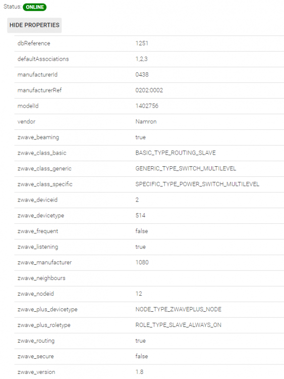

  4. RPi4 Openhabian openHAB 2.5.10-1 Samler spørsmålene i samme tråd. Nettopp inkludert Namron LED Dimmer z-wave 200w Det virker som Dimmeren rapporterer gammel verdi tilbake når jeg endrer lysstyrken via OpenHab. Openhab viser 100% Openhab dimmer til 50% Lyset dimmes Openhab viser den som 100% (Lyset er fortsatt 50%) Hvis jeg dimmer manuelt på hjulet, så blir det stående riktig verdi. Det er den verdien Openhab alltid går tilbake til.
