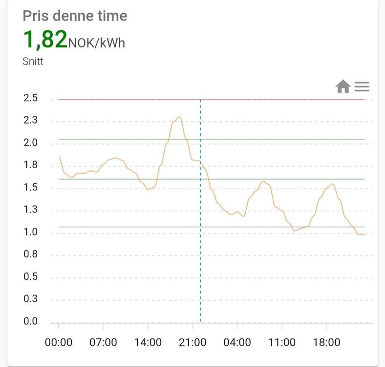

  10. Her er det jeg har fått fikset i første runde. Ser at de fleste eksempler i den lange tråden om dette, kun vise sluttprisen pr døgn i header feltet. Men jeg endret til å vise prisen akkurat nå. type: custom:apexcharts-card header: show: true title: Pris denne time show_states: true colorize_states: true series: - entity: sensor.nordpool_kwh_bergen_nok_3_095_025 show: in_header: false name: Snitt type: line curve: straight float_precision: 4 stroke_width: 1 opacity: 0.4 color: green data_generator: > return [[start, entity.attributes.average*0.9],[end, entity.attributes.average*0.9]]; - entity: sensor.nordpool_kwh_bergen_nok_3_095_025 show: in_header: false name: Snitt type: line curve: straight float_precision: 4 stroke_width: 1 opacity: 0.4 color: green data_generator: > return [[start, entity.attributes.average*1.15],[end, entity.attributes.average*1.15]]; - entity: sensor.nordpool_kwh_bergen_nok_3_095_025 show: in_header: true name: Snitt type: column curve: straight float_precision: 4 stroke_width: 1 opacity: 0.4 color: green data_generator: > return [[moment.calendar, entity.attributes.current_price],[moment.calendar, entity.attributes.current_price]]; - entity: sensor.nordpool_kwh_bergen_nok_3_095_025 show: in_header: false name: Pris type: line curve: smooth float_precision: 4 stroke_width: 1 opacity: 0.5 color: rgb(255,111,0) data_generator: > return entity.attributes.raw_today.map(p => [new Date(p.start), p.value]) .concat( entity.attributes.raw_tomorrow.map(p => [new Date(p.start), p.value])) - entity: sensor.nordpool_kwh_bergen_nok_3_095_025 show: in_header: false name: Snitt type: line curve: straight float_precision: 4 stroke_width: 1 opacity: 0.4 color: red data_generator: > return [[start, entity.attributes.average*1.4],[end, entity.attributes.average*1.4]]; - entity: sensor.nordpool_kwh_bergen_nok_3_095_025 show: in_header: false name: Snitt type: line curve: straight float_precision: 4 stroke_width: 1 opacity: 0.4 color: gray data_generator: > return [[start, entity.attributes.average*0.6],[end, entity.attributes.average*0.6]]; now: show: true graph_span: 2d span: start: day locale: nb apex_config: chart: height: 300px zoom: enabled: true toolbar: show: true tools: zoom: true zoomin: false zoomout: false pan: false reset: true legend: show: false dataLabels: enabled: false xaxis: type: datetime labels: datetimeFormatter: month: ddd day: ddd yaxis: forceNiceScale: false min: 0

  13. Ja. Nordpool ser ut til å fungere som det skal.
