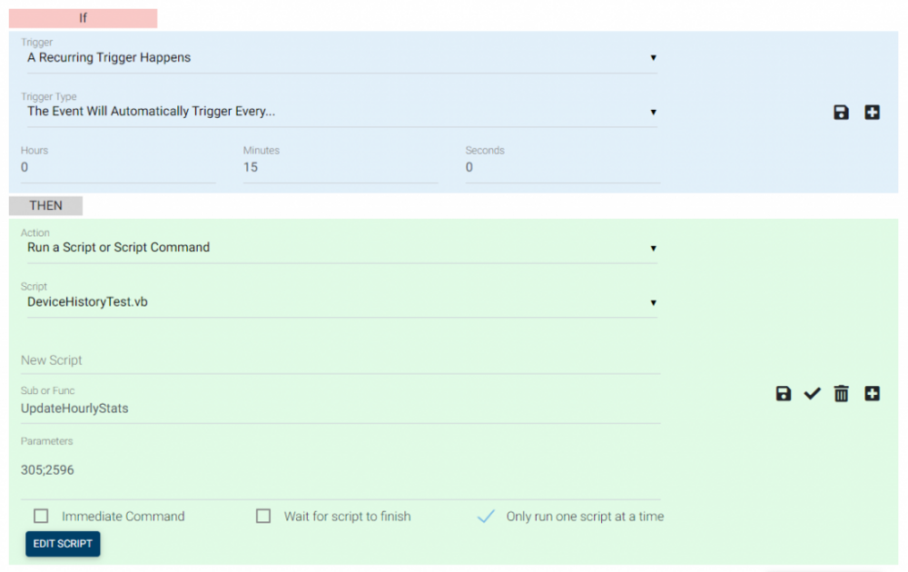

Slik? Eg skal ta meg ein tur på skulen. Public Sub UpdateHourlyStats(parms As String) Dim intSourceRef As Integer Dim intDestRef As Integer Dim dtmFrom As Date Dim dtmTo As Date Dim strDeviceStats As String Dim astrStats() As String Const IDX_STATS_MIN As Integer = 0 Const IDX_STATS_MAX As Integer = 1 Const IDX_STATS_AVG As Integer = 2 Const IDX_STATS_COUNT As Integer = 3 Dim dblMin As Double Dim dblMax As Double Dim dblAvg As Double Dim intCount As Integer 'figure out the parameters intSourceRef = CType(parms.Split(";")(0), Integer) intDestRef = CType(parms.Split(";")(1), Integer) dtmTo = Date.Now dtmFrom = dtmTo.AddHours(-1) hs.WriteLog("Device History", "Getting updated stats for device " & intSourceRef & " from '" & dtmFrom.ToString() & "' to '" & dtmTo.ToString() & "' ...") 'Ask the plugin for the stats strDeviceStats = hs.PluginFunction("Device History", "", "GetRangeStats", {intSourceRef.ToString(), dtmFrom.ToString(), dtmTo.ToString()}) 'Parse the response into discrete variables astrStats = strDeviceStats.Split("|") If astrStats.Length() = 4 Then dblMin = astrStats(IDX_STATS_MIN) dblMax = astrStats(IDX_STATS_MAX) dblAvg = astrStats(IDX_STATS_AVG) intCount = astrStats(IDX_STATS_COUNT) 'Do something with the output hs.WriteLog("Device History", "Device " & intSourceRef & " ranged from " & dblMin & " to " & dblMax & ", with an average value of " & dblAvg & " taken from " & intCount & " changes.") hs.WriteLog("Device History", "Updating device " & intDestRef & " with value " & dblAvg) hs.SetDeviceValueByRef(intDestRef, dblAvg, True) Else hs.WriteLog("Error", "Retrieval of stats for device " & intSourceRef & " failed.") End If End Sub Takk for push, fann knapp for "kode" på verktøylinja på innlegg. Device ref, blir det det samme som Device Id. Dette virker logisk. I tillegg fekk eg tips om korleis kjøre script (må prøve meg fram med eit intervall som er ofte nok, men uten å overlaste serveren): Vedlagt bilde. Sourceref blir Tibberseer Power (Deviceref 212) og Destsourceref blir det virtuelle devicet med det korte navnet "Live snittforbruk kWh sist time" (Deviceref 54)? Eg må sjekke om det er riktig innstilling på devicet, men har lagt inn det skal vere 3desimaler og benevnelsen kWh på slutten, då burde det kunne få gjennomsnittsverdi frå scriptet. Mvh
Hei! Utvikleren til Device History plugin-et har vore meget serviceinnstilt og levert kode for å hente ut gjennomsnittsverdi frå sist time og skrive verdien til et virtuellt device. På denne måten kan eg sammenligne direkte med en verdi, istedenfor å gjennomsnittsberegne for kvar enkelt funksjon. Koden er som følger: Public Sub UpdateHourlyStats(parms As String) Dim intSourceRef As Integer Dim intDestRef As Integer Dim dtmFrom As Date Dim dtmTo As Date Dim strDeviceStats As String Dim astrStats() As String Const IDX_STATS_MIN As Integer = 0 Const IDX_STATS_MAX As Integer = 1 Const IDX_STATS_AVG As Integer = 2 Const IDX_STATS_COUNT As Integer = 3 Dim dblMin As Double Dim dblMax As Double Dim dblAvg As Double Dim intCount As Integer 'figure out the parameters intSourceRef = CType(parms.Split(";")(0), Integer) intDestRef = CType(parms.Split(";")(1), Integer) dtmTo = Date.Now dtmFrom = dtmTo.AddHours(-1) hs.WriteLog("Device History", "Getting updated stats for device " & intSourceRef & " from '" & dtmFrom.ToString() & "' to '" & dtmTo.ToString() & "' ...") 'Ask the plugin for the stats strDeviceStats = hs.PluginFunction("Device History", "", "GetRangeStats", {intSourceRef.ToString(), dtmFrom.ToString(), dtmTo.ToString()}) 'Parse the response into discrete variables astrStats = strDeviceStats.Split("|") If astrStats.Length() = 4 Then dblMin = astrStats(IDX_STATS_MIN) dblMax = astrStats(IDX_STATS_MAX) dblAvg = astrStats(IDX_STATS_AVG) intCount = astrStats(IDX_STATS_COUNT) 'Do something with the output hs.WriteLog("Device History", "Device " & intSourceRef & " ranged from " & dblMin & " to " & dblMax & ", with an average value of " & dblAvg & " taken from " & intCount & " changes.") hs.WriteLog("Device History", "Updating device " & intDestRef & " with value " & dblAvg) hs.SetDeviceValueByRef(intDestRef, dblAvg, True) Else hs.WriteLog("Error", "Retrieval of stats for device " & intSourceRef & " failed.") End If End Sub Korleis lagre som .vb fil? Og så må eg ha litt rettleiing på kva som er rett device-ref. Er det root-device, eller ref på funksjoner etc. Edit: I tillegg ser det ut til eg også må lære å legge inn kode som skjult tekst og rett formatering, slik som de andre bruker.

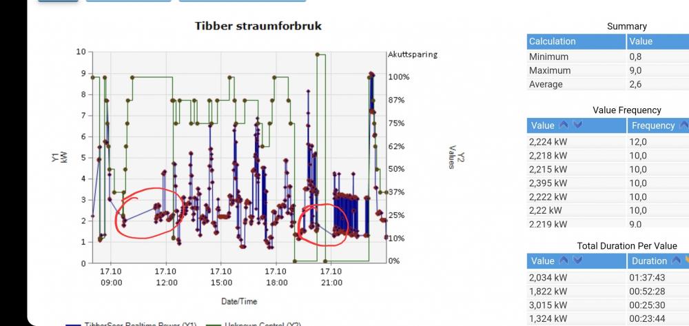

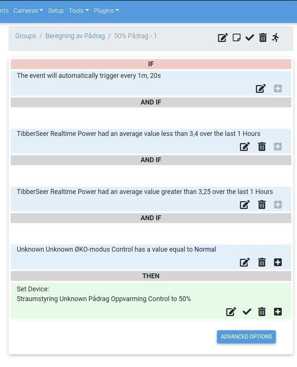

Hei! Eg styrer etter kontinuerlig gjennomsnittsberegning målt forbruk frå tibber Pulse. Styrer 7gulv, 1ovn og varmtvannsberederen. Normalt har eg 7-8kWh forbruk max i mnd, peak kan vere 10-12kWh. (EDIT: MED effektstyring har eg klart å holde meg på ca 4kWh max høgaste time i mnd. Dvs innsparing på ca 150kr i mnd mot 8kWh som er vanlig verdi uregulert. ) Dette ved hjelp av EasyTrigger og Device History plugins. Og masse regler. Det fungerer heilt OK, men drømmen er Stigvi sin PID-regulator konvertert til HomeSeer. Det mest irriterende er tidvis utfall av data frå tibber API-et, slik eg kjører uten måling i etpar timar her og der, dette gjev ofte overskridelser. På søndag hadde eg 2 lengre utfall som resulterte i ny "rekord" i forbruk denne mnd. (I rødt) Effekttariffen min blir målt på den eine(1) timen med høgst forbruk i mnd. Eg har kjøpt inn et zigbee HAN-interface, men har ikkje fått tid å bytte ut Pulse enda. Har også splitter, men usikker på om den fungerer riktig. -

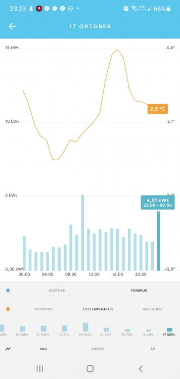

Hei igjen. 🙂 Effekttariffen har komt for å bli. I mitt tilfelle, er det den eine timen i mnd med høgast forbruk. Det gjenstår å få sammenligne kontinuerlig snittforbruk sist time med device i pluginet Device History (Håper på at utvikler vil hjelpe..) For å forsøke spare mest mulig på effektleddet, vil eg forsøke på nytt den 1. kvar måned, istaden for å benytte fast verdi. Dette fordi strømforbruket endrar seg med årstid og utetemperatur, etc. Eg har oppretta 2stk device for å lagre forbruk sist time og max forbruk hittil denne mnd. Så sammenliknar eg device:forbruk sist time, med device: max forbruk hittil denne mnd. Er forbruket sist time høgare enn max denne mnd, blir verdien fra sist time skrevet over til device: max forbruk hittil denne mnd. Device: max forbruk hittil denne mnd blir satt til 1 kWh kvar 1. i mnd klokka 00.00. Dvs det blir litt sparsomt med oppvarming den 1. I mnd, men ettersom forbruket påvirker Device: Max forbruk hittil denne mnd, vil det bli tillatt oppvarming etter behov. Mvh

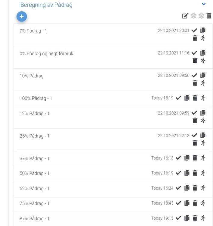

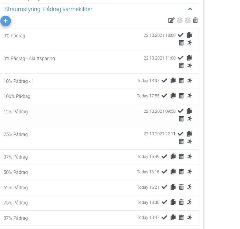

Hei. Light oppdatering etter montering av Aeotec Heavy duty smart switch på varmtvannsberederen: Dette har absolutt god effekt som virkemiddel for å regulere gjennomsnittsforbruk. Målet er å aldri overstige 5kW pr. time, det vil gi ca 150kr i innsparing pr mnd på effektleddet. Eg har 10 ulike reguleringstrinn. Første forsøk på å sette inn varmtvannsberederen var når gjennomsnittsberegning av forbruket nådde 4,5KWt. Dette gav ikkje tilstrekkelig effekt, slik at når vaskemaskin, tørketrommel og oppvaskmaskin kjørte samtidig, blei det overskridelser. Som ekstra utfordring har barna eit plaskebasseng på taket med uregulert 3KWt varmeelement som gir mellom 30 og 35grader vanntemperatur, dette går en times tid i slengen, med etpar timer pause, ser det ut som. Screenshot 2, tilsvarende situasjon. Viser nåværende prioritering av varmtvannsberederen, som slår ut ved mindre enn 75% pådrag. (100% betyr full tilgang på effekt, 0% betyr fullt sparemodus). Ved 62%(snittforbruk over 3KWt)forsvinn 2kW effekt når berederen blir slått av, og dette gir tidlegare effekt og lavare snittforbruk. Det ser ut til vi får nok varmtvatn sjølv med lavere prioritering. Mvh
