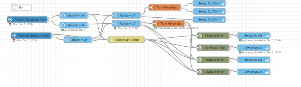

	Hvis du tenker at mitt første eksempel var overveldende og ikke så lett å starte med. Her har jeg et enkelt eksempel, som egentlig gjør det samme, men uten alle mine ulike varianter. Denne skrur på lyset ved bevegelse og av igjen etter 5 minutter. Ved ny bevegelse, så restarter timeren. [{"id":"b45d30d7.035af","type":"server-state-changed","z":"8df51809.834bf8","name":"Motion changed to = on","server":"ac20270b.4d8de8","version":1,"exposeToHomeAssistant":false,"haConfig":[{"property":"name","value":""},{"property":"icon","value":""}],"entityidfilter":"binary_sensor.motionsensor_do","entityidfiltertype":"exact","outputinitially":true,"state_type":"str","haltifstate":"on","halt_if_type":"str","halt_if_compare":"is","outputs":2,"output_only_on_state_change":true,"for":0,"forType":"num","forUnits":"minutes","ignorePrevStateNull":false,"ignorePrevStateUnknown":false,"ignorePrevStateUnavailable":false,"ignoreCurrentStateUnknown":false,"ignoreCurrentStateUnavailable":false,"x":300,"y":700,"wires":[["e2328b38.5d6508"],[]]},{"id":"e2328b38.5d6508","type":"trigger","z":"8df51809.834bf8","name":"","op1":"5 minutter trigger","op2":"0","op1type":"str","op2type":"str","duration":"5","extend":false,"overrideDelay":false,"units":"min","reset":"","bytopic":"all","topic":"topic","outputs":2,"x":510,"y":700,"wires":[["246e942f.91e84c"],["e1f24b3a.e02ac8"]]},{"id":"246e942f.91e84c","type":"api-call-service","z":"8df51809.834bf8","name":"Set lys Do 75%","server":"ac20270b.4d8de8","version":1,"debugenabled":false,"service_domain":"light","service":"turn_on","entityId":"light.lys_do","data":"{\"brightness_pct\":75,\"transition\":3}","dataType":"json","mergecontext":"","output_location":"","output_location_type":"none","mustacheAltTags":false,"x":700,"y":680,"wires":[[]]},{"id":"e1f24b3a.e02ac8","type":"api-call-service","z":"8df51809.834bf8","name":"Turn off lys Do","server":"ac20270b.4d8de8","version":1,"debugenabled":false,"service_domain":"light","service":"turn_off","entityId":"light.lys_do","data":"","dataType":"json","mergecontext":"","output_location":"","output_location_type":"none","mustacheAltTags":false,"x":700,"y":720,"wires":[[]]},{"id":"ac20270b.4d8de8","type":"server","name":"Home Assistant","legacy":false,"addon":true,"rejectUnauthorizedCerts":true,"ha_boolean":"y|yes|true|on|home|open","connectionDelay":true,"cacheJson":true}]

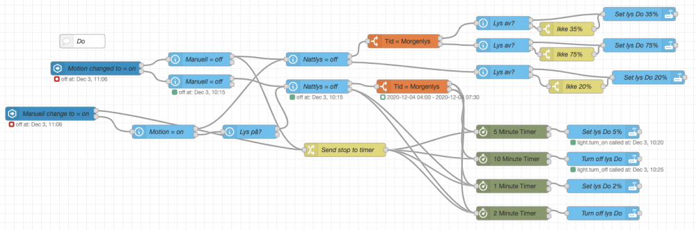

	Oppdatert versjon 🙂 [{"id":"8df51809.834bf8","type":"tab","label":"Do","disabled":false,"info":""},{"id":"b7f54c85.d6ff","type":"time-range-switch","z":"8df51809.834bf8","name":"Tid = Morgenlys","lat":"","lon":"","startTime":"04:00","endTime":"07:30","startOffset":0,"endOffset":0,"x":1000,"y":100,"wires":[["9f9a8fa8.2a143"],["f580ce3c.8e034"]]},{"id":"263e8cc4.4e41b4","type":"change","z":"8df51809.834bf8","name":"Send stop to timer","rules":[{"t":"set","p":"payload","pt":"msg","to":"stop","tot":"str"}],"action":"","property":"","from":"","to":"","reg":false,"x":870,"y":340,"wires":[["4f6e7d61.187c84","42f99041.a5957","2c7f01c5.d1483e","77713445.407e8c"]]},{"id":"59a50991.835d68","type":"server-state-changed","z":"8df51809.834bf8","name":"Motion changed to = on","server":"ac20270b.4d8de8","version":1,"exposeToHomeAssistant":false,"haConfig":[{"property":"name","value":""},{"property":"icon","value":""}],"entityidfilter":"binary_sensor.motionsensor_do","entityidfiltertype":"exact","outputinitially":true,"state_type":"str","haltifstate":"on","halt_if_type":"str","halt_if_compare":"is","outputs":2,"output_only_on_state_change":true,"for":0,"forType":"num","forUnits":"minutes","ignorePrevStateNull":false,"ignorePrevStateUnknown":false,"ignorePrevStateUnavailable":false,"ignoreCurrentStateUnknown":false,"ignoreCurrentStateUnavailable":false,"x":320,"y":160,"wires":[["3712c8ee.ab6208"],["4a8517b.ff755e8"]]},{"id":"cef25b82.07e338","type":"server-state-changed","z":"8df51809.834bf8","name":"Manuell change to = on","server":"ac20270b.4d8de8","version":1,"exposeToHomeAssistant":false,"haConfig":[{"property":"name","value":""},{"property":"icon","value":""}],"entityidfilter":"input_boolean.manuell_do","entityidfiltertype":"exact","outputinitially":true,"state_type":"str","haltifstate":"on","halt_if_type":"str","halt_if_compare":"is","outputs":2,"output_only_on_state_change":true,"for":0,"forType":"num","forUnits":"minutes","ignorePrevStateNull":false,"ignorePrevStateUnknown":false,"ignorePrevStateUnavailable":false,"ignoreCurrentStateUnknown":false,"ignoreCurrentStateUnavailable":false,"x":220,"y":260,"wires":[["263e8cc4.4e41b4"],["759ad7f.a917628"]]},{"id":"759ad7f.a917628","type":"api-current-state","z":"8df51809.834bf8","name":"Motion = on","server":"ac20270b.4d8de8","version":1,"outputs":2,"halt_if":"on","halt_if_type":"str","halt_if_compare":"is","override_topic":false,"entity_id":"binary_sensor.motionsensor_do","state_type":"str","state_location":"payload","override_payload":"msg","entity_location":"data","override_data":"msg","blockInputOverrides":false,"x":470,"y":300,"wires":[["d2be6cb0.8aa88"],["6d0ee25f.ae05bc"]]},{"id":"3712c8ee.ab6208","type":"api-current-state","z":"8df51809.834bf8","name":"Manuell = off","server":"ac20270b.4d8de8","version":1,"outputs":2,"halt_if":"off","halt_if_type":"str","halt_if_compare":"is","override_topic":false,"entity_id":"input_boolean.manuell_do","state_type":"str","state_location":"payload","override_payload":"msg","entity_location":"data","override_data":"msg","blockInputOverrides":false,"x":550,"y":140,"wires":[["263e8cc4.4e41b4","d2be6cb0.8aa88"],[]]},{"id":"4a8517b.ff755e8","type":"api-current-state","z":"8df51809.834bf8","name":"Manuell = off","server":"ac20270b.4d8de8","version":1,"outputs":2,"halt_if":"off","halt_if_type":"str","halt_if_compare":"is","override_topic":false,"entity_id":"input_boolean.manuell_do","state_type":"str","state_location":"payload","override_payload":"msg","entity_location":"data","override_data":"msg","blockInputOverrides":false,"x":550,"y":189,"wires":[["2de39bf8.bdb664"],[]]},{"id":"d2be6cb0.8aa88","type":"api-current-state","z":"8df51809.834bf8","name":"Nattlys = off","server":"ac20270b.4d8de8","version":1,"outputs":2,"halt_if":"off","halt_if_type":"str","halt_if_compare":"is","override_topic":false,"entity_id":"input_boolean.scene_nattlys","state_type":"str","state_location":"payload","override_payload":"msg","entity_location":"data","override_data":"msg","blockInputOverrides":false,"x":810,"y":140,"wires":[["b7f54c85.d6ff"],["49f45adb.35ff04"]]},{"id":"2de39bf8.bdb664","type":"api-current-state","z":"8df51809.834bf8","name":"Nattlys = off","server":"ac20270b.4d8de8","version":1,"outputs":2,"halt_if":"off","halt_if_type":"str","halt_if_compare":"is","override_topic":false,"entity_id":"input_boolean.scene_nattlys","state_type":"str","state_location":"payload","override_payload":"msg","entity_location":"data","override_data":"msg","blockInputOverrides":false,"x":810,"y":200,"wires":[["a22383a7.08742"],["2c7f01c5.d1483e","77713445.407e8c"]]},{"id":"4f6e7d61.187c84","type":"stoptimer","z":"8df51809.834bf8","duration":"5","units":"Minute","payloadtype":"num","payloadval":"0","name":"","x":1240,"y":300,"wires":[["99bfd66f.91ce28"],[]]},{"id":"42f99041.a5957","type":"stoptimer","z":"8df51809.834bf8","duration":"10","units":"Minute","payloadtype":"num","payloadval":"0","name":"","x":1240,"y":360,"wires":[["43054cb1.e3ae64"],[]]},{"id":"8cf81503.5305d8","type":"api-call-service","z":"8df51809.834bf8","name":"Set lys Do 75%","server":"ac20270b.4d8de8","version":1,"debugenabled":false,"service_domain":"light","service":"turn_on","entityId":"light.lys_do","data":"{\"brightness_pct\":75,\"transition\":3}","dataType":"json","mergecontext":"","output_location":"","output_location_type":"none","mustacheAltTags":false,"x":1520,"y":109,"wires":[[]]},{"id":"2c7f01c5.d1483e","type":"stoptimer","z":"8df51809.834bf8","duration":"1","units":"Minute","payloadtype":"num","payloadval":"0","name":"","x":1240,"y":420,"wires":[["ed2f0ad9.e1a8f8"],[]]},{"id":"867f9a4e.6b3de8","type":"api-call-service","z":"8df51809.834bf8","name":"Set lys Do 35%","server":"ac20270b.4d8de8","version":1,"debugenabled":false,"service_domain":"light","service":"turn_on","entityId":"light.lys_do","data":"{\"brightness_pct\":35,\"transition\":4}","dataType":"json","mergecontext":"","output_location":"","output_location_type":"none","mustacheAltTags":false,"x":1520,"y":40,"wires":[[]]},{"id":"f7096aba.1c3eb8","type":"api-call-service","z":"8df51809.834bf8","name":"Set lys Do 20%","server":"ac20270b.4d8de8","version":1,"debugenabled":false,"service_domain":"light","service":"turn_on","entityId":"light.lys_do","data":"{\"brightness_pct\":20,\"transition\":4}","dataType":"json","mergecontext":"","output_location":"","output_location_type":"none","mustacheAltTags":false,"x":1540,"y":180,"wires":[[]]},{"id":"a22383a7.08742","type":"time-range-switch","z":"8df51809.834bf8","name":"Tid = Morgenlys","lat":"","lon":"","startTime":"04:00","endTime":"07:30","startOffset":0,"endOffset":0,"x":1020,"y":200,"wires":[["2c7f01c5.d1483e","77713445.407e8c"],["4f6e7d61.187c84","42f99041.a5957"]]},{"id":"77713445.407e8c","type":"stoptimer","z":"8df51809.834bf8","duration":"2","units":"Minute","payloadtype":"num","payloadval":"0","name":"","x":1240,"y":480,"wires":[["f6b91247.e0e51"],[]]},{"id":"f6b91247.e0e51","type":"api-call-service","z":"8df51809.834bf8","name":"Turn off lys Do","server":"ac20270b.4d8de8","version":1,"debugenabled":false,"service_domain":"light","service":"turn_off","entityId":"light.lys_do","data":"","dataType":"json","mergecontext":"","output_location":"","output_location_type":"none","mustacheAltTags":false,"x":1440,"y":480,"wires":[[]]},{"id":"ed2f0ad9.e1a8f8","type":"api-call-service","z":"8df51809.834bf8","name":"Set lys Do 2%","server":"ac20270b.4d8de8","version":1,"debugenabled":false,"service_domain":"light","service":"turn_on","entityId":"light.lys_do","data":"{\"brightness_pct\":2,\"transition\":10}","dataType":"json","mergecontext":"","output_location":"","output_location_type":"none","mustacheAltTags":false,"x":1440,"y":420,"wires":[[]]},{"id":"43054cb1.e3ae64","type":"api-call-service","z":"8df51809.834bf8","name":"Turn off lys Do","server":"ac20270b.4d8de8","version":1,"debugenabled":false,"service_domain":"light","service":"turn_off","entityId":"light.lys_do","data":"","dataType":"json","mergecontext":"","output_location":"","output_location_type":"none","mustacheAltTags":false,"x":1440,"y":360,"wires":[[]]},{"id":"99bfd66f.91ce28","type":"api-call-service","z":"8df51809.834bf8","name":"Set lys Do 5%","server":"ac20270b.4d8de8","version":1,"debugenabled":false,"service_domain":"light","service":"turn_on","entityId":"light.lys_do","data":"{\"brightness_pct\":5,\"transition\":10}","dataType":"json","mergecontext":"","output_location":"","output_location_type":"none","mustacheAltTags":false,"x":1440,"y":300,"wires":[[]]},{"id":"a5d88682.cbd918","type":"comment","z":"8df51809.834bf8","name":"Do","info":"","x":290,"y":100,"wires":[]},{"id":"6d0ee25f.ae05bc","type":"api-current-state","z":"8df51809.834bf8","name":"Lys på?","server":"ac20270b.4d8de8","version":1,"outputs":2,"halt_if":"on","halt_if_type":"str","halt_if_compare":"is","override_topic":false,"entity_id":"light.lys_do","state_type":"str","state_location":"payload","override_payload":"msg","entity_location":"data","override_data":"msg","blockInputOverrides":false,"x":660,"y":300,"wires":[["2de39bf8.bdb664"],[]]},{"id":"9f9a8fa8.2a143","type":"api-current-state","z":"8df51809.834bf8","name":"Lys av?","server":"ac20270b.4d8de8","version":1,"outputs":2,"halt_if":"off","halt_if_type":"str","halt_if_compare":"is","override_topic":false,"entity_id":"light.lys_do","state_type":"str","state_location":"payload","override_payload":"msg","entity_location":"data","override_data":"msg","blockInputOverrides":false,"x":1220,"y":60,"wires":[["867f9a4e.6b3de8"],["cb92530f.c8b22"]]},{"id":"cb92530f.c8b22","type":"switch","z":"8df51809.834bf8","name":"Ikke 35%","property":"data.attributes.brightness","propertyType":"msg","rules":[{"t":"neq","v":"35","vt":"num"}],"checkall":"true","repair":false,"outputs":1,"x":1360,"y":73,"wires":[["867f9a4e.6b3de8"]]},{"id":"f580ce3c.8e034","type":"api-current-state","z":"8df51809.834bf8","name":"Lys av?","server":"ac20270b.4d8de8","version":1,"outputs":2,"halt_if":"off","halt_if_type":"str","halt_if_compare":"is","override_topic":false,"entity_id":"light.lys_do","state_type":"str","state_location":"payload","override_payload":"msg","entity_location":"data","override_data":"msg","blockInputOverrides":false,"x":1220,"y":109,"wires":[["8cf81503.5305d8"],["60821e56.a5464"]]},{"id":"60821e56.a5464","type":"switch","z":"8df51809.834bf8","name":"Ikke 75%","property":"data.attributes.brightness","propertyType":"msg","rules":[{"t":"neq","v":"75","vt":"num"}],"checkall":"true","repair":false,"outputs":1,"x":1360,"y":129,"wires":[["8cf81503.5305d8"]]},{"id":"49f45adb.35ff04","type":"api-current-state","z":"8df51809.834bf8","name":"Lys av?","server":"ac20270b.4d8de8","version":1,"outputs":2,"halt_if":"off","halt_if_type":"str","halt_if_compare":"is","override_topic":false,"entity_id":"light.lys_do","state_type":"str","state_location":"payload","override_payload":"msg","entity_location":"data","override_data":"msg","blockInputOverrides":false,"x":1220,"y":168,"wires":[["f7096aba.1c3eb8"],["df9854c4.b5dcc8"]]},{"id":"df9854c4.b5dcc8","type":"switch","z":"8df51809.834bf8","name":"Ikke 20%","property":"data.attributes.brightness","propertyType":"msg","rules":[{"t":"neq","v":"20","vt":"num"}],"checkall":"true","repair":false,"outputs":1,"x":1380,"y":200,"wires":[["f7096aba.1c3eb8"]]},{"id":"ac20270b.4d8de8","type":"server","name":"Home Assistant","legacy":false,"addon":true,"rejectUnauthorizedCerts":true,"ha_boolean":"y|yes|true|on|home|open","connectionDelay":true,"cacheJson":true}]

	Litt kort om min erfaring før jeg poster her. Jeg er relativt fersk med Node-RED, men har holdt på med automasjon i flere år, blant annet WebCore for SmartThings og regelmotoren i HomeSeer. I det siste har jeg flyttet mer og mer av min automasjon fra HomeSeer til Node-RED. Node-RED kjører jeg på min Home Assistant installasjon. Jeg benytter automasjon for så mye jeg klarer, blant annet styring av lys etter bevegelse og tid på døgnet, varme etter tid på døgnet og status på huset (hjemme/borte), styring av dørlås og alarm etter presence. Her er en "enkel" styring av lyset på do. Denne kan se omfattende ut for de som er nye med Node-RED, men det er for å dekke våre scenarioer og behov for styring av lyset helt automatisk på doen. Jeg skal prøve å forklare flow'en, men først hva slags enheter som er benyttet her. Fysiske: Lys = Philips HUE. Koblet til Home Assistant via HUE gatewayen og standard Philips HUE integrasjon i Home Assistant. Motion = Bevegelsessensor fra Xiaomi Aqara. Koblet til Home Assistant via deconz installert i Home Assistant og USB-stick ConBee II som ZigBee-kontroller. Virtuelle i Home Assistant: Manuell = Virtuell node som gjør at vi kan skru av all automasjon. Noden lages ved hjelp av input_boolean i Home Assistant. Nattlys = Virtuell node som skrus av/på etter tidspunkt på døgnet. Noden lages ved hjelp av input_boolean i Home Assistant. Node-RED noder: Events state node - noden som trigger hele flow'en basert på endring fra enhetene nevnt over. Current state node - node som sjekker status på en enhet Tid = Time Range node i Node-RED. Timer = Stop timer node i Node-RED. Denne brukes for å skru av lyset etter x-minutter etter at det ikke lenger er bevegelse på doen. Stop to timer = Change node i Node-RED. Denne brukes til å endre payload'en til "stop". Grunnen til dette er at timeren nevnt over vil stoppe om den mottar en "stop"-melding. Dette gjør jeg for å resette timeren ved ny bevgelse i rommet og om manuell skrus på etter at timeren har startet. Call service node = Den som kaller en enhet og sender dataen jeg ønsker. Så forklaring til flow'en: VED ENDRING TIL BEVELGESE: Steg 1: Event - Ved bevegelse på do, så vil bevegelssensoren endres til "on" og noden "Motion change to = on" vil sende data ut på output 1. Steg 2: Status - Er den virtuelle bryteren "Manuell" "on" eller "off"? Hvis "off" så fortsetter flow'en på output 1 og til steg 3. Hvis "on" så sender den på output 2, der jeg ikke har noe og flow'en stopper. Steg 3a: Status - Samme som steg 2. Er den virtuelle brytere "on" eller off"? Hvis "off", send til output 1 og gå til steg 4. Hvis "on", output 2 og steg 5. Steg 3b: Stop timer. Bevegelse er detektert på do og "send stop to timer" sender "stop" videre til steg 8. Steg 4a: Nattlys fra steg 3a er bekreftet av og jeg bruker nå en "time range node" for å sjekke om tidsperioden er mellom 04.00-07.30, her kalt "Morgenlys". Er den innenfor denne tidsperion, output 1 og videre til steg 6. Utenfor tidsperioden, output 2 og videre til steg 7. Steg 4b: Timerne har fått meldingen "stop" fra steg 3b og hvis de telte nedover vil de nå bli stoppet. Steg 5: Nattlys fra steg 3a er av og jeg bruker navn en "call service node" til å dimme lyset på do opp til 20% over 4 sekunder. Flow'en er ferdig. Steg 6: Samme som steg 5. Lyset får nå sin melding, men ikke samme verdier som steg 5 hvor det er nattlys. Morgenlyset gir deg 35% dimmet over en tidsperiode på 4 sekunder. Flow'en er ferdig. Steg 7: Samme som steg 5, men nå er både nattlys og morgenlys utelukket og lyset dimmes til 75% over 3 sekunder. Flow'en er ferdig. VED ENDRING TIL IKKE BEVEGELSE: Steg 1: Event - Nå går det fra bevegelse til ikke bevegelse. Nå hopper jeg over steg 2, 3a og 4, da disse er like som stegene over. Steg 5: Avhengig av "nattlys", "morgenlys", "vanlig lys", så startes nå timerne. Ved "vanlig lys" så vil timeren 5 minutter og 10 minutter starte. Er det "nattlys" eller "morgenlys" så vil timeren 1 minutt og 2 minutter starte. Hvis timerne nå teller ned uten å få "stop" melding, så vil de sende data på output 1 og til steg 6. Steg 6: Timerne har telt ferdig og lysene får nå sin melding. Etter 5 minutter i perioden "vanlig lys" så vil lyset dimmes ned til 5% og etter 10 minutter skrus av. Flow'en er ferdig. VED ENDRING TIL MANUELL ON: Steg 1: Event - Den virtuelle noden "manuell" endres til "on" og sender data på output 1. Steg 2: Samme som 3b over. Manuell er trigget og vi må stoppe timere om de teller. Steg 3: Timere mottar meldingen "stop" og stopper hvis de teller ned. Flow'en er ferdig. VED ENDRING TIL MANUELL OFF: Denne er laget for å takle overgang fra "manuell" "on" til "manuell" off". Steg 1: Event - Den virtuelle noden "manuell" endres til "off" og sender data på output 2. Steg 2 alt 1: Status - Er det bevegelse i rommet så vil "Motion = on" sende på output 1 og avgengig av status ved de påfølgende nodene, sette lys til ønsket verdi. Steg 2 alt 2: Status - Er det ikke bevegelse i rommet så vil "Motion = on" sende på output 2 og avgengig av status ved de påfølgende nodene, starte ønske timer. Mens jeg skrev denne posten, så ser jeg at eksempelet mitt, som jeg trodde var komplett og ryddig, mangler en node for å sjekke om lys allerede er på. Dette bruker jeg i andre rom. Sånn er det i hjemmeautomasjonen, det er alltid forbedringsmuligheter. Jeg poster denne meldingen sånn den er, forbedrer flow'en og poster ny versjon av den under 😃 Ønsker du å se nærmere på denne flow'en eller implementere den hos deg. Kopier koden under og velg "import" i Node-RED: [{"id":"8df51809.834bf8","type":"tab","label":"Do","disabled":false,"info":""},{"id":"b7f54c85.d6ff","type":"time-range-switch","z":"8df51809.834bf8","name":"Tid = Morgenlys","lat":"","lon":"","startTime":"04:00","endTime":"07:30","startOffset":0,"endOffset":0,"x":1000,"y":40,"wires":[["867f9a4e.6b3de8"],["8cf81503.5305d8"]]},{"id":"263e8cc4.4e41b4","type":"change","z":"8df51809.834bf8","name":"Send stop to timer","rules":[{"t":"set","p":"payload","pt":"msg","to":"stop","tot":"str"}],"action":"","property":"","from":"","to":"","reg":false,"x":810,"y":200,"wires":[["4f6e7d61.187c84","42f99041.a5957","2c7f01c5.d1483e","77713445.407e8c"]]},{"id":"59a50991.835d68","type":"server-state-changed","z":"8df51809.834bf8","name":"Motion changed to = on","server":"ac20270b.4d8de8","version":1,"exposeToHomeAssistant":false,"haConfig":[{"property":"name","value":""},{"property":"icon","value":""}],"entityidfilter":"binary_sensor.motionsensor_do","entityidfiltertype":"exact","outputinitially":true,"state_type":"str","haltifstate":"on","halt_if_type":"str","halt_if_compare":"is","outputs":2,"output_only_on_state_change":true,"for":0,"forType":"num","forUnits":"minutes","ignorePrevStateNull":false,"ignorePrevStateUnknown":false,"ignorePrevStateUnavailable":false,"ignoreCurrentStateUnknown":false,"ignoreCurrentStateUnavailable":false,"x":320,"y":100,"wires":[["3712c8ee.ab6208"],["4a8517b.ff755e8"]]},{"id":"cef25b82.07e338","type":"server-state-changed","z":"8df51809.834bf8","name":"Manuell change to = on","server":"ac20270b.4d8de8","version":1,"exposeToHomeAssistant":false,"haConfig":[{"property":"name","value":""},{"property":"icon","value":""}],"entityidfilter":"input_boolean.manuell_do","entityidfiltertype":"exact","outputinitially":true,"state_type":"str","haltifstate":"on","halt_if_type":"str","halt_if_compare":"is","outputs":2,"output_only_on_state_change":true,"for":0,"forType":"num","forUnits":"minutes","ignorePrevStateNull":false,"ignorePrevStateUnknown":false,"ignorePrevStateUnavailable":false,"ignoreCurrentStateUnknown":false,"ignoreCurrentStateUnavailable":false,"x":340,"y":180,"wires":[["263e8cc4.4e41b4"],["759ad7f.a917628"]]},{"id":"759ad7f.a917628","type":"api-current-state","z":"8df51809.834bf8","name":"Motion = on","server":"ac20270b.4d8de8","version":1,"outputs":2,"halt_if":"on","halt_if_type":"str","halt_if_compare":"is","override_topic":false,"entity_id":"binary_sensor.motionsensor_do","state_type":"str","state_location":"payload","override_payload":"msg","entity_location":"data","override_data":"msg","blockInputOverrides":false,"x":570,"y":200,"wires":[["d2be6cb0.8aa88"],["2de39bf8.bdb664"]]},{"id":"3712c8ee.ab6208","type":"api-current-state","z":"8df51809.834bf8","name":"Manuell = off","server":"ac20270b.4d8de8","version":1,"outputs":2,"halt_if":"off","halt_if_type":"str","halt_if_compare":"is","override_topic":false,"entity_id":"input_boolean.manuell_do","state_type":"str","state_location":"payload","override_payload":"msg","entity_location":"data","override_data":"msg","blockInputOverrides":false,"x":550,"y":80,"wires":[["263e8cc4.4e41b4","d2be6cb0.8aa88"],[]]},{"id":"4a8517b.ff755e8","type":"api-current-state","z":"8df51809.834bf8","name":"Manuell = off","server":"ac20270b.4d8de8","version":1,"outputs":2,"halt_if":"off","halt_if_type":"str","halt_if_compare":"is","override_topic":false,"entity_id":"input_boolean.manuell_do","state_type":"str","state_location":"payload","override_payload":"msg","entity_location":"data","override_data":"msg","blockInputOverrides":false,"x":550,"y":129,"wires":[["2de39bf8.bdb664"],[]]},{"id":"d2be6cb0.8aa88","type":"api-current-state","z":"8df51809.834bf8","name":"Nattlys = off","server":"ac20270b.4d8de8","version":1,"outputs":2,"halt_if":"off","halt_if_type":"str","halt_if_compare":"is","override_topic":false,"entity_id":"input_boolean.scene_nattlys","state_type":"str","state_location":"payload","override_payload":"msg","entity_location":"data","override_data":"msg","blockInputOverrides":false,"x":810,"y":80,"wires":[["b7f54c85.d6ff"],["f7096aba.1c3eb8"]]},{"id":"2de39bf8.bdb664","type":"api-current-state","z":"8df51809.834bf8","name":"Nattlys = off","server":"ac20270b.4d8de8","version":1,"outputs":2,"halt_if":"off","halt_if_type":"str","halt_if_compare":"is","override_topic":false,"entity_id":"input_boolean.scene_nattlys","state_type":"str","state_location":"payload","override_payload":"msg","entity_location":"data","override_data":"msg","blockInputOverrides":false,"x":810,"y":120,"wires":[["a22383a7.08742"],["2c7f01c5.d1483e","77713445.407e8c"]]},{"id":"4f6e7d61.187c84","type":"stoptimer","z":"8df51809.834bf8","duration":"5","units":"Minute","payloadtype":"num","payloadval":"0","name":"","x":1240,"y":180,"wires":[["99bfd66f.91ce28"],[]]},{"id":"42f99041.a5957","type":"stoptimer","z":"8df51809.834bf8","duration":"10","units":"Minute","payloadtype":"num","payloadval":"0","name":"","x":1240,"y":240,"wires":[["43054cb1.e3ae64"],[]]},{"id":"8cf81503.5305d8","type":"api-call-service","z":"8df51809.834bf8","name":"Set lys Do 75%","server":"ac20270b.4d8de8","version":1,"debugenabled":false,"service_domain":"light","service":"turn_on","entityId":"light.lys_do","data":"{\"brightness_pct\":75,\"transition\":3}","dataType":"json","mergecontext":"","output_location":"","output_location_type":"none","mustacheAltTags":false,"x":1220,"y":60,"wires":[[]]},{"id":"2c7f01c5.d1483e","type":"stoptimer","z":"8df51809.834bf8","duration":"1","units":"Minute","payloadtype":"num","payloadval":"0","name":"","x":1240,"y":300,"wires":[["ed2f0ad9.e1a8f8"],[]]},{"id":"867f9a4e.6b3de8","type":"api-call-service","z":"8df51809.834bf8","name":"Set lys Do 35%","server":"ac20270b.4d8de8","version":1,"debugenabled":false,"service_domain":"light","service":"turn_on","entityId":"light.lys_do","data":"{\"brightness_pct\":35,\"transition\":4}","dataType":"json","mergecontext":"","output_location":"","output_location_type":"none","mustacheAltTags":false,"x":1220,"y":20,"wires":[[]]},{"id":"f7096aba.1c3eb8","type":"api-call-service","z":"8df51809.834bf8","name":"Set lys Do 20%","server":"ac20270b.4d8de8","version":1,"debugenabled":false,"service_domain":"light","service":"turn_on","entityId":"light.lys_do","data":"{\"brightness_pct\":20,\"transition\":4}","dataType":"json","mergecontext":"","output_location":"","output_location_type":"none","mustacheAltTags":false,"x":1220,"y":100,"wires":[[]]},{"id":"a22383a7.08742","type":"time-range-switch","z":"8df51809.834bf8","name":"Tid = Morgenlys","lat":"","lon":"","startTime":"04:00","endTime":"07:30","startOffset":0,"endOffset":0,"x":1020,"y":120,"wires":[["2c7f01c5.d1483e","77713445.407e8c"],["4f6e7d61.187c84","42f99041.a5957"]]},{"id":"77713445.407e8c","type":"stoptimer","z":"8df51809.834bf8","duration":"2","units":"Minute","payloadtype":"num","payloadval":"0","name":"","x":1240,"y":360,"wires":[["f6b91247.e0e51"],[]]},{"id":"f6b91247.e0e51","type":"api-call-service","z":"8df51809.834bf8","name":"Turn off lys Do","server":"ac20270b.4d8de8","version":1,"debugenabled":false,"service_domain":"light","service":"turn_off","entityId":"light.lys_do","data":"","dataType":"json","mergecontext":"","output_location":"","output_location_type":"none","mustacheAltTags":false,"x":1440,"y":360,"wires":[[]]},{"id":"ed2f0ad9.e1a8f8","type":"api-call-service","z":"8df51809.834bf8","name":"Set lys Do 2%","server":"ac20270b.4d8de8","version":1,"debugenabled":false,"service_domain":"light","service":"turn_on","entityId":"light.lys_do","data":"{\"brightness_pct\":2,\"transition\":10}","dataType":"json","mergecontext":"","output_location":"","output_location_type":"none","mustacheAltTags":false,"x":1440,"y":300,"wires":[[]]},{"id":"43054cb1.e3ae64","type":"api-call-service","z":"8df51809.834bf8","name":"Turn off lys Do","server":"ac20270b.4d8de8","version":1,"debugenabled":false,"service_domain":"light","service":"turn_off","entityId":"light.lys_do","data":"","dataType":"json","mergecontext":"","output_location":"","output_location_type":"none","mustacheAltTags":false,"x":1440,"y":240,"wires":[[]]},{"id":"99bfd66f.91ce28","type":"api-call-service","z":"8df51809.834bf8","name":"Set lys Do 5%","server":"ac20270b.4d8de8","version":1,"debugenabled":false,"service_domain":"light","service":"turn_on","entityId":"light.lys_do","data":"{\"brightness_pct\":5,\"transition\":10}","dataType":"json","mergecontext":"","output_location":"","output_location_type":"none","mustacheAltTags":false,"x":1440,"y":180,"wires":[[]]},{"id":"a5d88682.cbd918","type":"comment","z":"8df51809.834bf8","name":"Do","info":"","x":290,"y":40,"wires":[]},{"id":"ac20270b.4d8de8","type":"server","name":"Home Assistant","legacy":false,"addon":true,"rejectUnauthorizedCerts":true,"ha_boolean":"y|yes|true|on|home|open","connectionDelay":true,"cacheJson":true}] Denne posten ser jeg at ble ganske lang, jeg tenker ikke at poster trenger være så omfattende og beskrivende som denne. Det viktigste tenker jeg er å få se andres eksempler og bli inspirert til å automatisere selv. Post dine eksempler uten forklaring om du ønsker!
