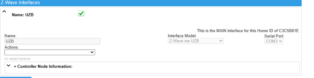

Har lasta ned Simplicity Studio og åpner PC Controller Z-wave fra der, men ingen USB dukker opp. Trykker på tannhjulet og finner COM6 Silicon lab USB, men får feilmelding at "The required Z-wave controller device was not found". Jeg har gjennomført akkurat som dokumentasjonen sier. Er det noen annen måte å sjekke/oppdatere firmware på? -

update: Har nå prøvd flere ganger å ekskludere og inkludere ulike termostater, z-water og en nexans smartplug. Alle melder at de ikke får frem child devices. Begynner å lurer på om det er noe med Z-Stick'en? Andre forslag? Add Node started... Activate the 'Add to Network' function on the device... A new node is being added... Adding a new SLAVE NODE... DONE - Add Node Operation is Complete. Done. Node 10 Added. Reloading (importing) node information... Synchronizing node information with HomeSeer and creating new device(s) as necessary... Synchronize nodes finished. Number of device nodes to be created/added = 1 Node: 10 Supports Class(es): VERSION, ZWAVEPLUS_INFO, ASSOCIATION, CONFIGURATION, THERMOSTAT_MODE_V3, THERMOSTAT_OPERATING_STATE_V2, THERMOSTAT_SETPOINT, METER_V2, NOTIFICATION_V6, PROTECTION, SENSOR_MULTILEVEL_V8, MULTI_CHANNEL_V3, MULTI_INSTANCE_ASSOCIATION, MANUFACTURER_SPECIFIC_V2, DEVICE_RESET_LOCALLY, INDICATOR, POWERLEVEL, ASSOCIATION_GRP_INFO_V2, TRANSPORT_SERVICE, SUPERVISION, FIRMWARE_UPDATE_MD Node 10 is a Z-Wave Plus node. Retrieving ZWPlus Info... Warning: Node 10 did not respond to a request for the Command Class Version for MULTI_INSTANCE/MULTI_CHANNEL Warning: The device at node 10 should result in 5 child devices being created, but the node interrogation currently has 0. This may still result in a successful child creation. Finished. Saving network information to file: ZNet_FD53E73E_2025-07-29_10.40.47.ZWave. Please wait... Done! -

Starter rett på en TLDR: UZB1 konka. Ny Z-Stick7. Startet med excludering fra UZB1. Ente opp med ERASE this interface and create new network. Inkludert en Fibaro Dimmer - alt OK. 2 stk. HeatIt termostat (trm2fx og TFM6) er inkludert, men kun root vises - ingen child devicer. Kjøre fabrikkoppsett på termostater først. Har prøvd optimalisering. Startet med HS3 for lenge siden, og var med på oppgradering til HS4. Har i en periode forsøkt FutureHome, men da de gikk konkurs, valgte jeg å vekke opp Win10-PC'en og HS4 igjen. Likte nemlig ikke automasjonen i FH. HS er lettere å forstå for mannen i gata, og kan sette opp forholdsvis komplekse eventer uten å måtte lære seg thingplex. Vel vel. Føler meg neste litt newbie igjen på HS.

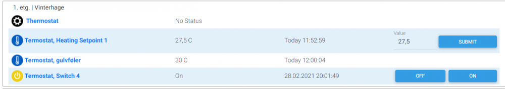

Det er tydeligvis noe slark i systemet her, ja. Se innlegget mitt over. Det virker som om noen devicer kommuniserer mens andre ikke gjør det. Og det skifter litt ila. dagen. Ser i bildeeksempelet over at f.eks. sett-temperatur på kjøkkenet (Heating Setpoint1) og status on/off (Switch4) ikke funker. Akkurat de to signalen jeg trenger å få til å funke sammen. Så det er mer enn kun assosasjonene. Er det noen måte å "reboote" Heatit Z-TRM3 på uten å miste innstillingene? Eller må jeg rett og slett kjøre factory reset og remove/add igjen, med alt det som følger med avkonfig etterpå? -

Det er jo det som er det store spørsmålet. Hvorfor fungerer ikke assosiasjonen uten HS og er det faktisk slik at den skal kunne kjøre uten HS? Her er skjermbilde fra innstillingene til termostaten på kjøkkenet: "Kjeller Teknisk Z-water" er on/off devicen som trigger motorventilen i fordelerskapet. "Switch 4 - kjøkken" er On/Off devicen til termostaten som har gulvføler på kjøkkenet. Dette funger bra så lenge HS kjører. -

Æsj, jeg må tweeke litt mer på denne posten. Sorry @Moskus. Det tok bare noen dager så er termostat og z-water off igjen. Det virker som om min opprinnelige magefølelse var riktig. Altså at selv om gulvføleren passerer set-temp, så endres ikke alltid status på termostaten. Firmware er 3.6. Må jeg gå veien om fabrikkoppsett igjen på alle varmekurser? Jeg begynner å bli litt engstelig for mitt nye parkettgulv, da det plutselig var registrert nesten 30 grader på gulvføler, uten at termostaten hadde satt seg til off. Sånn skjer også andre vei, at vi våkner om morgenen og har 20 grader på føleren og set-temp. er 25, og status er fortsatt off. Er det Heatit vers2 som er ustabil? -

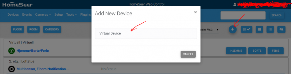

Det ser ut til at jeg ikke får lagt til ny device i HS4. Jeg har installert en ny Heat it termostat og satt den i add mode, og trykker + Add new device i HS4 (windows). Da får jeg bare "virtual device" som valg. Hva gjør jeg feil? Er HS4 fortsatt i beta? Finnes jo ikke noe brukerdokumentasjon på hjemmesiden.
