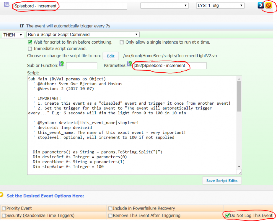

Med utgangspunkt i @Moskus sitt IncrementLight.vb har jeg laget en "v2", som bare krever ett event (ellers ikke så mye annerledes ?):
Sub Main (ByVal params as Object)
  ' @Author: Sven-Ove Bjerkan and Moskus
  ' @Version: 2 (2017-10-07)
  ' IMPORTANT!
  ' 1. Create this event as a "disabled" event and trigger it once from another event!
  ' 2. Set the trigger for this event to "The event will automatically trigger every..." E.g: 6 seconds will dim the light from 0 to 100 in 10 min
  ' @Syntax: deviceid|this_event_name|stoplevel
  ' deviceid: lamp deviceid
  ' this_event_name: The name of this exact event - very important!
  ' stoplevel: optional, will increment to 100 if not supplied
  Dim parameters() as String = params.ToString.Split("|")
  Dim deviceRef As Integer = parameters(0)
  Dim eventName As String = parameters(1)
  Dim stopValue As Integer = 100
  If parameters.length = 3 Then
       stopValue = parameters(2)
  End If
  Dim deviceValue As Integer = hs.DeviceValue(deviceRef)
  deviceValue = deviceValue + 1
  If deviceValue > 100 Then
    deviceValue = 100
  End If
  If deviceValue < 1 Then
    deviceValue = 1
  End If
  hs.EnableEvent(eventName)
  'Exit if the device is already at maximum, i.e. "On"
  If hs.CAPIGetStatus(deviceRef).Status = "On" Or deviceValue > stopValue Then
    hs.DisableEvent(eventName)
    Exit Sub
  End If
  'Find the correct CAPI control to execute. I really miss Linq!!!
  For Each cc As HomeSeerAPI.CAPIControl In hs.CAPIGetControl(deviceRef)
    If cc.ControlValue = deviceValue Then
    'Set the correct dim level
    hs.CAPIControlHandler(cc)
    'We're done, so let's exit!
    Exit Sub
    End If
  Next
End Sub
Jeg prøver å benytte dette scriptet for å dimme opp flere lyssoner (4) i stue/kjøkken samtidig om morgenen. Jeg har da et event som trigges av Alexa og det eventet trigger igjen et event for hver sone, som er satt opp som beskrevet over. Alle Dimme-eventene benytter samme .vb-script.
Dette fungerer ikke... Selv med "Only allow a single instance to run at a time" disabled og enablet "Wait for script to finish before continuing", samt andre kombinasjoner av disse, så starter ikke dimming på alle sonene. Kun en eller to soner begynner å dimmes opp.
Noen som har forslag til fiks her?
Eller skal jeg kanskje bare utvide scriptet slik at et script dimmer alle 4 sonene? Det bør vel være inne rekkevidde, selv for en novise som meg, når alle sonene skal dimmes opp til samme nivå.
