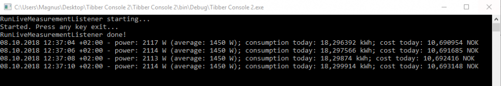

bjornepappa Posted October 8, 2018 Posted October 8, 2018 (edited) 19 minutter siden, Moskus skrev: Dette ser jo lovende ut... Tibber pulse? Har du fått opna HAN? Edited October 8, 2018 by bjornepappa Quote
Moskus Posted October 8, 2018 Author Posted October 8, 2018 22 minutter siden, bjornepappa skrev: Tibber pulse? Har du fått opna HAN? Niks (pga. treige Lyse). Men test-token hos Tibber har data. Quote
bjornepappa Posted October 8, 2018 Posted October 8, 2018 Då er det håp! For øvrig samme problem her. Fått data inn i TibberSeer? ? Quote
