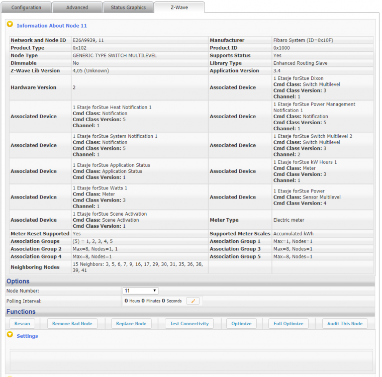

  1. Testet metoden over. Men homeseer viser fortsatt gammel FW (3.4) selvom HC Lite viste ver 3.5. Får heller ikke vist assosiasjoner. (Er grået ut). Settings viser ikke noe, bare tomme linjer. Men en kan dog justere lysstyrken som før... Kjører siste versjon av HC3 (3.0.0.548) Zwave 3.0.2.0 Kjørte en rescan: mar-10 09:41:24 Z-Wave ApplicationCommandHandler from Network: E26A9939 Node: 42 HANDLING: COMMAND_CLASS_BASIC_V2 Frame(7)=3 mar-10 09:41:09 Z-Wave Error Cannot get additional details about node 11 as there is no node information available. mar-10 09:41:09 Z-Wave uzb1: Node 11 CONTROLS class: COMMAND_CLASS_SCENE_ACTIVATION mar-10 09:41:09 Z-Wave uzb1: Node 11 CONTROLS class: COMMAND_CLASS_MARK mar-10 09:41:09 Z-Wave uzb1: Node 11 CONTROLS class: COMMAND_CLASS_APPLICATION_STATUS mar-10 09:41:09 Z-Wave uzb1: Node 11 CONTROLS class: COMMAND_CLASS_SWITCH_ALL mar-10 09:41:09 Z-Wave uzb1: Node 11 CONTROLS class: COMMAND_CLASS_NOTIFICATION_V6 mar-10 09:41:09 Z-Wave uzb1: Node 11 CONTROLS class: COMMAND_CLASS_PROTECTION mar-10 09:41:09 Z-Wave uzb1: Node 11 CONTROLS class: COMMAND_CLASS_MULTI_CHANNEL_V3 mar-10 09:41:09 Z-Wave uzb1: Node 11 CONTROLS class: COMMAND_CLASS_MULTI_INSTANCE_ASSOCIATION mar-10 09:41:09 Z-Wave uzb1: Node 11 CONTROLS class: COMMAND_CLASS_METER_V2 mar-10 09:41:09 Z-Wave uzb1: Node 11 CONTROLS class: COMMAND_CLASS_SENSOR_MULTILEVEL_V8 mar-10 09:41:09 Z-Wave uzb1: Node 11 CONTROLS class: COMMAND_CLASS_CONFIGURATION mar-10 09:41:09 Z-Wave uzb1: Node 11 CONTROLS class: COMMAND_CLASS_CRC_16_ENCAP mar-10 09:41:09 Z-Wave uzb1: Node 11 CONTROLS class: COMMAND_CLASS_FIRMWARE_UPDATE_MD mar-10 09:41:09 Z-Wave uzb1: Node 11 CONTROLS class: COMMAND_CLASS_SECURITY mar-10 09:41:09 Z-Wave uzb1: Node 11 CONTROLS class: COMMAND_CLASS_POWERLEVEL mar-10 09:41:09 Z-Wave uzb1: Node 11 CONTROLS class: COMMAND_CLASS_ASSOCIATION mar-10 09:41:09 Z-Wave uzb1: Node 11 CONTROLS class: COMMAND_CLASS_ASSOCIATION_GRP_INFO_V2 mar-10 09:41:09 Z-Wave uzb1: Node 11 CONTROLS class: COMMAND_CLASS_DEVICE_RESET_LOCALLY mar-10 09:41:09 Z-Wave uzb1: Node 11 CONTROLS class: COMMAND_CLASS_SWITCH_MULTILEVEL_V3 mar-10 09:41:09 Z-Wave uzb1: Node 11 CONTROLS class: COMMAND_CLASS_MANUFACTURER_SPECIFIC_V2 mar-10 09:41:09 Z-Wave uzb1: Node 11 CONTROLS class: COMMAND_CLASS_VERSION mar-10 09:41:09 Z-Wave uzb1: Node 11 CONTROLS class: COMMAND_CLASS_BASIC_V2 mar-10 09:41:09 Z-Wave uzb1: Node 11 CONTROLS class: COMMAND_CLASS_ZWAVEPLUS_INFO mar-10 09:41:09 Z-Wave uzb1: Node 11 is reporting 22 command classes in the node information. mar-10 09:41:09 Z-Wave uzb1: Node 11 controls class: COMMAND_CLASS_SCENE_ACTIVATION mar-10 09:41:09 Z-Wave uzb1: Node 11 supports class: COMMAND_CLASS_MARK mar-10 09:41:09 Z-Wave uzb1: Node 11 supports class: COMMAND_CLASS_APPLICATION_STATUS mar-10 09:41:09 Z-Wave uzb1: Node 11 supports class: COMMAND_CLASS_SWITCH_ALL mar-10 09:41:09 Z-Wave uzb1: Node 11 supports class: COMMAND_CLASS_NOTIFICATION_V6 mar-10 09:41:09 Z-Wave uzb1: Node 11 supports class: COMMAND_CLASS_PROTECTION mar-10 09:41:09 Z-Wave uzb1: Node 11 supports class: COMMAND_CLASS_MULTI_CHANNEL_V3 mar-10 09:41:09 Z-Wave uzb1: Node 11 supports class: COMMAND_CLASS_MULTI_INSTANCE_ASSOCIATION mar-10 09:41:09 Z-Wave uzb1: Node 11 supports class: COMMAND_CLASS_METER_V2 mar-10 09:41:09 Z-Wave uzb1: Node 11 supports class: COMMAND_CLASS_SENSOR_MULTILEVEL_V8 mar-10 09:41:09 Z-Wave uzb1: Node 11 supports class: COMMAND_CLASS_CONFIGURATION mar-10 09:41:09 Z-Wave uzb1: Node 11 supports class: COMMAND_CLASS_CRC_16_ENCAP mar-10 09:41:09 Z-Wave uzb1: Node 11 supports class: COMMAND_CLASS_FIRMWARE_UPDATE_MD mar-10 09:41:09 Z-Wave uzb1: Node 11 supports class: COMMAND_CLASS_SECURITY mar-10 09:41:09 Z-Wave uzb1: Node 11 supports class: COMMAND_CLASS_POWERLEVEL mar-10 09:41:09 Z-Wave uzb1: Node 11 supports class: COMMAND_CLASS_ASSOCIATION mar-10 09:41:09 Z-Wave uzb1: Node 11 supports class: COMMAND_CLASS_ASSOCIATION_GRP_INFO_V2 mar-10 09:41:09 Z-Wave uzb1: Node 11 supports class: COMMAND_CLASS_DEVICE_RESET_LOCALLY mar-10 09:41:09 Z-Wave uzb1: Node 11 supports class: COMMAND_CLASS_SWITCH_MULTILEVEL_V3 mar-10 09:41:09 Z-Wave uzb1: Node 11 supports class: COMMAND_CLASS_MANUFACTURER_SPECIFIC_V2 mar-10 09:41:09 Z-Wave uzb1: Node 11 supports class: COMMAND_CLASS_VERSION mar-10 09:41:09 Z-Wave uzb1: Node 11 supports class: COMMAND_CLASS_BASIC_V2 mar-10 09:41:09 Z-Wave uzb1: Node 11 supports class: COMMAND_CLASS_ZWAVEPLUS_INFO mar-10 09:41:09 Z-Wave Node info frame from node 11 mar-10 09:41:09 Z-Wave uzb1: Contacting node 11 to get supported features mar-10 09:41:09 Z-Wave uzb1: Sending to node 11 (UnSecured) CC=COMMAND_CLASS_NO_OPERATION mar-10 09:41:09 Z-Wave Checking if we can reach node 11 mar-10 09:41:09 Z-Wave uzb1: Node 11 CONTROLS class: COMMAND_CLASS_SCENE_ACTIVATION mar-10 09:41:09 Z-Wave uzb1: Node 11 CONTROLS class: COMMAND_CLASS_MARK mar-10 09:41:09 Z-Wave uzb1: Node 11 CONTROLS class: COMMAND_CLASS_APPLICATION_STATUS mar-10 09:41:09 Z-Wave uzb1: Node 11 CONTROLS class: COMMAND_CLASS_SWITCH_ALL mar-10 09:41:09 Z-Wave uzb1: Node 11 CONTROLS class: COMMAND_CLASS_NOTIFICATION_V6 mar-10 09:41:09 Z-Wave uzb1: Node 11 CONTROLS class: COMMAND_CLASS_PROTECTION mar-10 09:41:09 Z-Wave uzb1: Node 11 CONTROLS class: COMMAND_CLASS_MULTI_CHANNEL_V3 mar-10 09:41:09 Z-Wave uzb1: Node 11 CONTROLS class: COMMAND_CLASS_MULTI_INSTANCE_ASSOCIATION mar-10 09:41:09 Z-Wave uzb1: Node 11 CONTROLS class: COMMAND_CLASS_METER_V2 mar-10 09:41:09 Z-Wave uzb1: Node 11 CONTROLS class: COMMAND_CLASS_SENSOR_MULTILEVEL_V8 mar-10 09:41:09 Z-Wave uzb1: Node 11 CONTROLS class: COMMAND_CLASS_CONFIGURATION mar-10 09:41:09 Z-Wave uzb1: Node 11 CONTROLS class: COMMAND_CLASS_CRC_16_ENCAP mar-10 09:41:09 Z-Wave uzb1: Node 11 CONTROLS class: COMMAND_CLASS_FIRMWARE_UPDATE_MD mar-10 09:41:09 Z-Wave uzb1: Node 11 CONTROLS class: COMMAND_CLASS_SECURITY mar-10 09:41:09 Z-Wave uzb1: Node 11 CONTROLS class: COMMAND_CLASS_POWERLEVEL mar-10 09:41:09 Z-Wave uzb1: Node 11 CONTROLS class: COMMAND_CLASS_ASSOCIATION mar-10 09:41:09 Z-Wave uzb1: Node 11 CONTROLS class: COMMAND_CLASS_ASSOCIATION_GRP_INFO_V2 mar-10 09:41:09 Z-Wave uzb1: Node 11 CONTROLS class: COMMAND_CLASS_DEVICE_RESET_LOCALLY mar-10 09:41:09 Z-Wave uzb1: Node 11 CONTROLS class: COMMAND_CLASS_SWITCH_MULTILEVEL_V3 mar-10 09:41:09 Z-Wave uzb1: Node 11 CONTROLS class: COMMAND_CLASS_MANUFACTURER_SPECIFIC_V2 mar-10 09:41:09 Z-Wave uzb1: Node 11 CONTROLS class: COMMAND_CLASS_VERSION mar-10 09:41:09 Z-Wave uzb1: Node 11 CONTROLS class: COMMAND_CLASS_BASIC_V2 mar-10 09:41:09 Z-Wave uzb1: Node 11 CONTROLS class: COMMAND_CLASS_ZWAVEPLUS_INFO mar-10 09:41:09 Z-Wave uzb1: Node 11 is reporting 22 command classes in the node information. mar-10 09:41:09 Z-Wave uzb1: Node 11 controls class: COMMAND_CLASS_SCENE_ACTIVATION mar-10 09:41:09 Z-Wave uzb1: Node 11 supports class: COMMAND_CLASS_MARK mar-10 09:41:09 Z-Wave uzb1: Node 11 supports class: COMMAND_CLASS_APPLICATION_STATUS mar-10 09:41:09 Z-Wave uzb1: Node 11 supports class: COMMAND_CLASS_SWITCH_ALL mar-10 09:41:09 Z-Wave uzb1: Node 11 supports class: COMMAND_CLASS_NOTIFICATION_V6 mar-10 09:41:09 Z-Wave uzb1: Node 11 supports class: COMMAND_CLASS_PROTECTION mar-10 09:41:09 Z-Wave uzb1: Node 11 supports class: COMMAND_CLASS_MULTI_CHANNEL_V3 mar-10 09:41:09 Z-Wave uzb1: Node 11 supports class: COMMAND_CLASS_MULTI_INSTANCE_ASSOCIATION mar-10 09:41:09 Z-Wave uzb1: Node 11 supports class: COMMAND_CLASS_METER_V2 mar-10 09:41:09 Z-Wave uzb1: Node 11 supports class: COMMAND_CLASS_SENSOR_MULTILEVEL_V8 mar-10 09:41:09 Z-Wave uzb1: Node 11 supports class: COMMAND_CLASS_CONFIGURATION mar-10 09:41:09 Z-Wave uzb1: Node 11 supports class: COMMAND_CLASS_CRC_16_ENCAP mar-10 09:41:09 Z-Wave uzb1: Node 11 supports class: COMMAND_CLASS_FIRMWARE_UPDATE_MD mar-10 09:41:09 Z-Wave uzb1: Node 11 supports class: COMMAND_CLASS_SECURITY mar-10 09:41:09 Z-Wave uzb1: Node 11 supports class: COMMAND_CLASS_POWERLEVEL mar-10 09:41:09 Z-Wave uzb1: Node 11 supports class: COMMAND_CLASS_ASSOCIATION mar-10 09:41:09 Z-Wave uzb1: Node 11 supports class: COMMAND_CLASS_ASSOCIATION_GRP_INFO_V2 mar-10 09:41:09 Z-Wave uzb1: Node 11 supports class: COMMAND_CLASS_DEVICE_RESET_LOCALLY mar-10 09:41:09 Z-Wave uzb1: Node 11 supports class: COMMAND_CLASS_SWITCH_MULTILEVEL_V3 mar-10 09:41:09 Z-Wave uzb1: Node 11 supports class: COMMAND_CLASS_MANUFACTURER_SPECIFIC_V2 mar-10 09:41:09 Z-Wave uzb1: Node 11 supports class: COMMAND_CLASS_VERSION mar-10 09:41:09 Z-Wave uzb1: Node 11 supports class: COMMAND_CLASS_BASIC_V2 mar-10 09:41:09 Z-Wave uzb1: Node 11 supports class: COMMAND_CLASS_ZWAVEPLUS_INFO mar-10 09:41:09 Z-Wave Node info frame from node 11 mar-10 09:41:09 Z-Wave uzb1: Contacting node 11 to get supported features mar-10 09:41:09 Z-Wave uzb1: Sending to node 11 (UnSecured) CC=COMMAND_CLASS_NO_OPERATION mar-10 09:41:09 Z-Wave Checking if we can reach node 11 mar-10 09:41:09 Z-Wave Getting class information for node 11... mar-10 09:41:09 Z-Wave Device synchronization needs to get Z-Wave class information for one node. mar-10 09:41:09 Z-Wave Syncing Z-Wave nodes with device list... Sent fra min SM-G960F via Tapatalk
